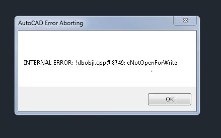

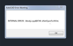

One of the following error messages appears when opening an existing model in the AutoCAD integrated platform:
"INTERNAL ERROR: !dbobji.cpp@8749: eNotOpenForWrite"
"INTERNAL ERROR: !dbobji.cpp@8673: eNotOpenForWrite"
Solution - AutoCAD 2022 and 2023
With AutoCAD 2022 integration in version 10.03.04.XX and higher (and later with AutoCAD 2023 integration that will be available in future versions), there is a known issue (reference # 708152) that can cause this error to occur when opening existing DWGs that had been previously saved using AutoCAD 2010 or older, including those with XREFs saved in an older version. After you dismiss the message AutoCAD offers to save the model:
"AutoCAD Alert ... AutoCAD cannot continue. You can attempt to save changes into the following file... After you save your changes, you can open or recover the file. Should AutoCAD try to save your changes?"
Clicking Yes or No redisplays the message and a few seconds after that AutoCAD crashes, disappears and displays the AutoCAD Error Report dialog.
As of June 22nd, 2022 a patch is available to resolve this issue for version 10.03.05.05 of the Water products and 10.03.04.53 of the Storm and Sewer products. This patch is available to users with a subscription by contacting Technical Support (Service Request / Forum) This fix will also be included in future new versions, so the other solution is to upgrade to a newer version when available.
