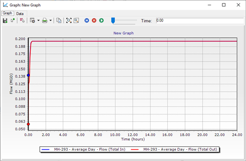

If you are viewing these results in the properties of a manhole or catchbasin, you may be viewing the results at time zero when the model may be in a state of flux. Typically the results in the first hour or two of the simulation are not always accurate due to the dry pipes initially filling. It is generally best to graph the time series results and ignore the initial filling period. Using the same example above, we can see that the inflow and outflow results are equal after the initial timestep:

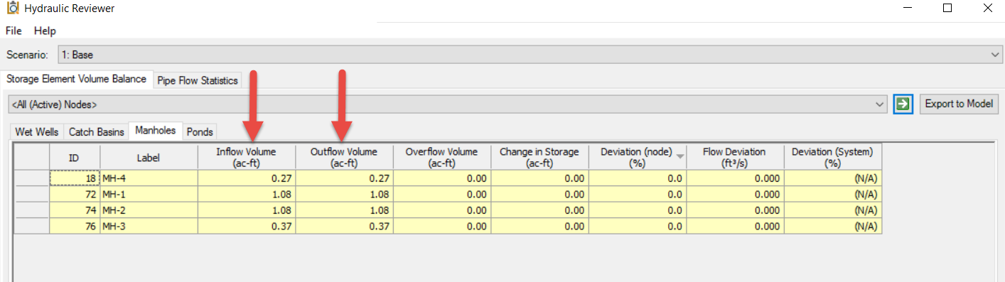

To ensure the volume mass balance is occurring, open the Hydraulic Reviewer tool (available for Implicit and Explicit solvers only, under Analysis > Analysis Tools > More), since this shows the mass balance based on volume for all storage element types (including manholes). Make sure that you account for any overflow, too.
If there is a large %deviation (continuity error) for that particular manhole in the Hydraulic Reviewer, it means that the model is unstable and you may need to tweak the calculation options to get better results.
