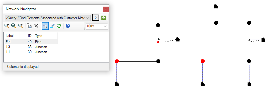

Consider the following example case where the selected (red) customer meters on the left side of the network have a residential demand pattern and you need to create a selection set of the junctions associated with them.

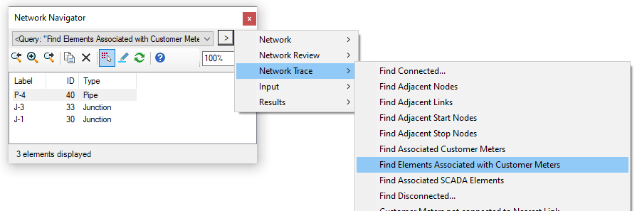

  2. With the customer meters from step #1 still selected, open Network Navigator and run the query "Find Elements Associated with Customer Meters".
  3. Click the "select in drawing" button at the top of the list of elements. The junctions and pipes associated with those customer meters will now be selected:
  4. Right click in the drawing, choose "Create Selection Set" and provide a name such as "Residential Demand Junctions".

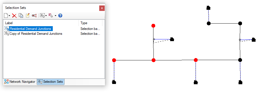

  5. We now need to select the junction adjacent to the pipes associated with customer meters. First, open the Selection Sets manager (from the View menu), select the selection set you created in step 4 and click the Duplicate button. The name of the new selection set will have the prefix "Copy of".

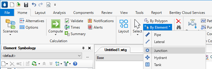

  6. From the Home menu > Calculation, click "By Element" > "Junction" to select all junctions in the model.
  7. Right click in the drawing, choose "Remove from selection set", select the copy of your selection set from step 5 and click OK. The "Copy of" selection set will now only contain the pipes associated with the desired customer meters.
  8. Double click on the "copy of" selection set from the selection set manager to select those pipes. Right click in the drawing, choose "Remove from selection set" and choose the original selection set you had created in step 4 ("Residential Demand Junctions" using the example above) and click OK. This will remove the pipes from the selection set so that it only contains junctions.

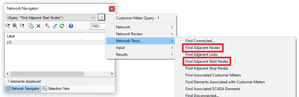

  9. Double click on the "copy of" selection set from the selection set manager to select those pipes again. Now, open Network Navigator and run the query "Find Adjacent Nodes" (to select nodes on both ends of the selected pipes) or "Find Adjacent Start Nodes" (to select only the upstream/start node associated with the pipes.)
    1. Note that the demand from the associated customer meter can be distributed to both the start and/or stop node of the pipe depending on the value you enter for the "Demand Distribution (Start)" field in the customer meter properties. If the default 50% is used, you may want to run the "Find Adjacent Nodes" query to select the junctions on both ends of the pipe.
  10. Click the "select in drawing" button at the top of Network Navigator to select the junctions based on the query you just ran.
