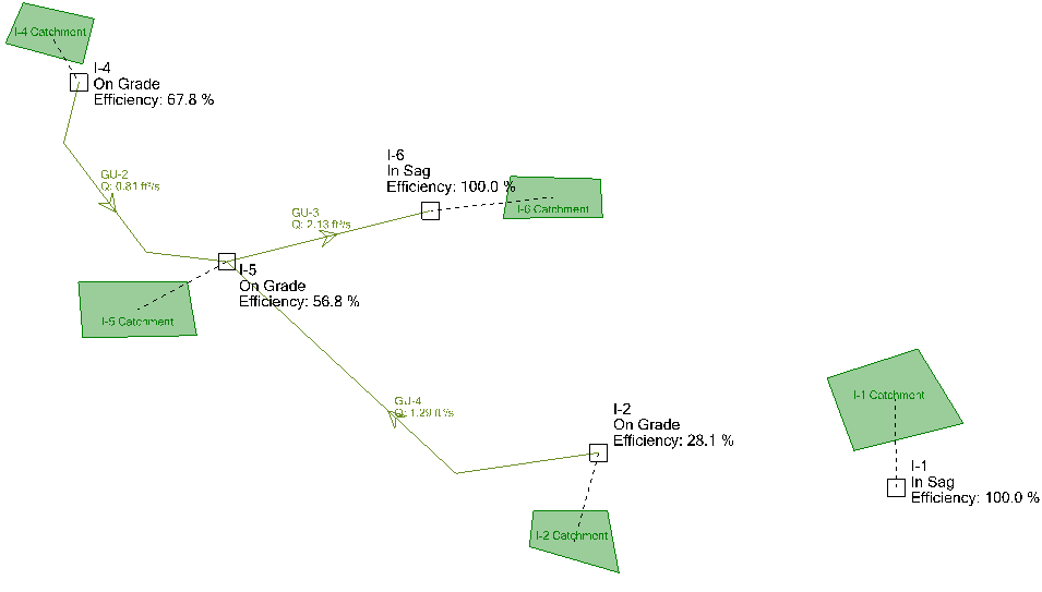

Yes, inlet-only hydraulics can be performed in versions 08.11.04 and higher. You can simply lay out the Catchments (with Storm Data), Catchbasins (with inlets) and gutters and the program will calculate the inlet capture efficiency, bypass flow, etc.
This can be useful for analyzing road drainage design before designing the subsurface piping. In earlier versions of the software, in order to calculate the inlet capacities, conduits needed to be connected to the catchbasins to direct captured subsurface flow.

Example Model
An example model with surface gutter hydraulics only can be downloaded from the below link. Note that you will need to have version 10.01.00.70 or greater to open this model. This model is intended as a supplemental example, to illustrate a surface gutter network.
