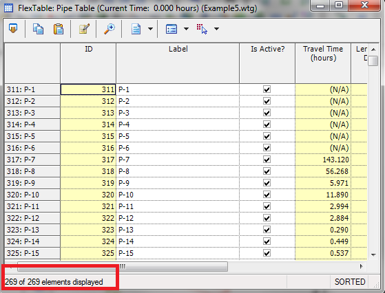

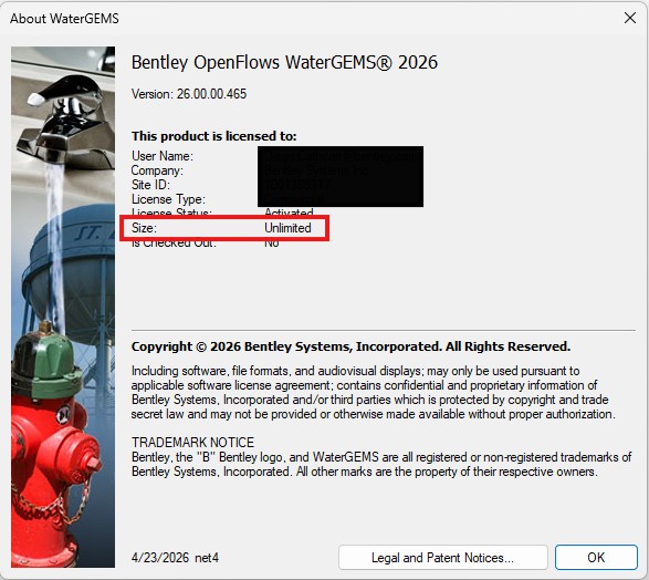

  1.  First check the size of the license the program is using by going to to Help > About [Product Name] and locate the area that says "Size", so you can note this number.
  2. Locate the flextable for the particular element in question, as noted by the user notification. Open that flextable and note the number in the lower left corner of the flextable for this particular element (see screen shot below). This will allow you to determine how many of those elements you have in your model.
  3. If that number is greater than the number you have available in your license you will have to either: A) If your company has an E365 or SELECT Open Access license use the directions below under the "Your license size is not being read correctly by your software" section to choose a new Feature Level, which is described in step 5  B) If the "size" is the correct size that you own and you cannot change it: reduce that number by skeletonizing your model C) Reduce that number by exporting part of your model to make a new model so that both models are under the number of elements limited by the license OR D) Call your Bentley account manager (1-800-BENTLEY) and purchase a higher feature level.
If you know the license size for your software is larger than what is showing under the size area in the Help > About WaterCAD, you'll need to select the appropriate Feature Level.
The steps to do this depend on the version you're using, as a new Licensing methodology was introduced in Late 2018 starting with versions 10.02.XX.XX.
CONNECT Edition Update 2 (10.02.XX.XX) and later: Setting the License Feature Level in the Feature Level Selector
