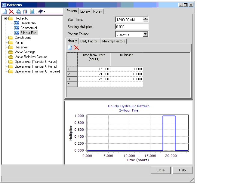

How do you set up an EPS (Extended Period Simulation) scenario for fire flow that would run for a certain amount of time?
Or, how can you compare automated fireflow results to a manual EPS check?
In some cases you may want to see the impact of the duration of a fire event, such as how long it will take to drain storage tanks. The traditional automated fire flow tool is a steady state run only, so you must manually set up an EPS simulation that uses a pattern to peak the demand at whichever hydrants or junctions you'd like to run the fire flow on.
The screenshot below shows how you might set your pattern up of you were running a 3 hour fire flow at 2,000 L/min from hours 18-20 from your simulation start time.

- Demand conditions elsewhere in the model: If you have demand patterns, you will need to use an EPS Snapshot with your automated fireflow run, where the time is set to time that you are observing during the EPS run. This will ensure that pattern multipliers are applied to the demands so as to make an equivalent "apples to apples" comparison. Also, ensure that the available fireflow demand that you have added to the node in question is removed in the fireflow scenario that you are comparing to, otherwise it will be counted twice (unless you have selected the option in the firelfow alternative to replace baseline demands). Lastly, your EPS scenario should have a pattern applied to the fireflow demand (see above) to simulate when and for how long the fire will occur, otherwise the demand will be applied during the entire simulation.
