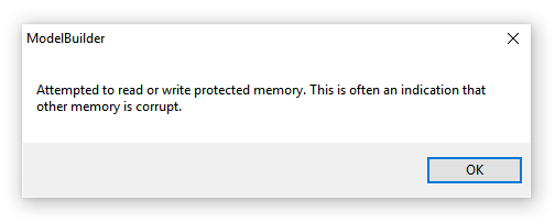

Error when importing a .DXF file with ModelBuilder "Attempted to read or write protected memory..."
Product(s):WaterGEMS, WaterCAD, HAMMER, SewerGEMS, SewerCAD, StormCAD, CivilStorm, PondPack
Version(s):CONNECT Edition, 08.11.XX.XX
Area:Input and Data Layout
When importing a DXF file using ModelBuilder the following error appears:
"Attempted to read or write protected memory. This is often an indication that other memory is corrupt."
Solution 1
If the originalĀ CAD line work was exported to a DXF file, then try saving as a DXF instead.
Solution 2
  1. Open the original CAD file inĀ a CAD editing application (eg. MicroStation, AutoCAD).
  2. Save the file as a DGN.
  3. Save that DGN as a DXF.
  4. Use the new DXF to import the data into ModelBuilder.
Solution 3
There may be an issue with the seed/template file that was used to create the original CAD file.
Try copying the linework to a new file that uses a different seed/template file.
