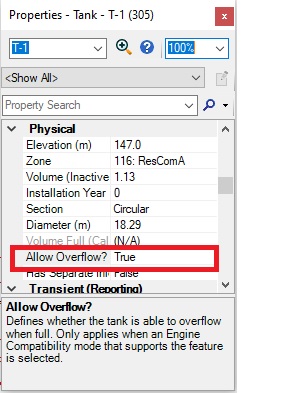

Starting the CONNECT Edition Update 4 release of WaterGEMS and WaterCAD, there is now an option that allows to the tank to overflow.
To use this feature, open the tank Properties grid and set the property field “Allow Overflow?” to True. With this setting, the tank can overflow during the simulation.
If “Allow Overflow?” is set to True and the tank is full, you will see a user notification that the tank is overflowing. In addition, if “Allow Overflow?” is set to True, the built-in tank altitude valve is not used. This means that there will continue to be flow to the tank if the tank is full.
Controls to keep the tank from overflowing would still optimal to avoid water loss in the system.
If "Allow tank overflow?" is set to False, the tank will operate with the built in altitude valve. These feature is available if the Engine Compatibility is set to WaterGEMS 2.2, WaterGEMS 2.00.12, WaterGEMS 2.00.10, or EPANET 2.2.
