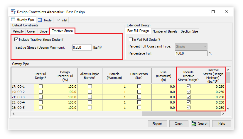

Tractive Stress Fields
The target tractive stress required to have self-cleaning conduits can be specified globally in the calculation option field "Tractive Stress (Global Minimum)".
Local minimums can also be specified on a per-pipe basis and will override the global target. To do this, set the conduit/channel property "Use Local Minimum Stress (Local Minimum)" to True and enter the target value for that individual element into the field "Tractive Stress (Local Minimum)".

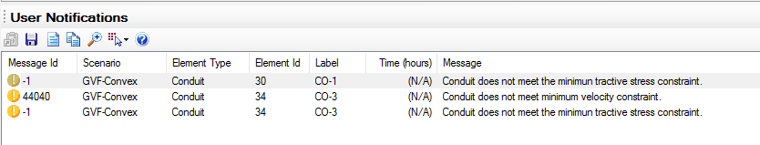

Using Tractive Stress as Design Criteria
Starting with the release of CONNECT Edition (version 10.00.00.40 and later) tractive stress be included in constraint based design.
The tractive stress constraint will not be met if there is a conflict with either the maximum Cover or maximum Velocity constraints.
Similar to other design constraints, there will be warnings if the new tractive stress constraint is not met, these warnings are only shown if the tractive stress design is included in the design process (the "Include Tractive Stress Design" check box is checked).

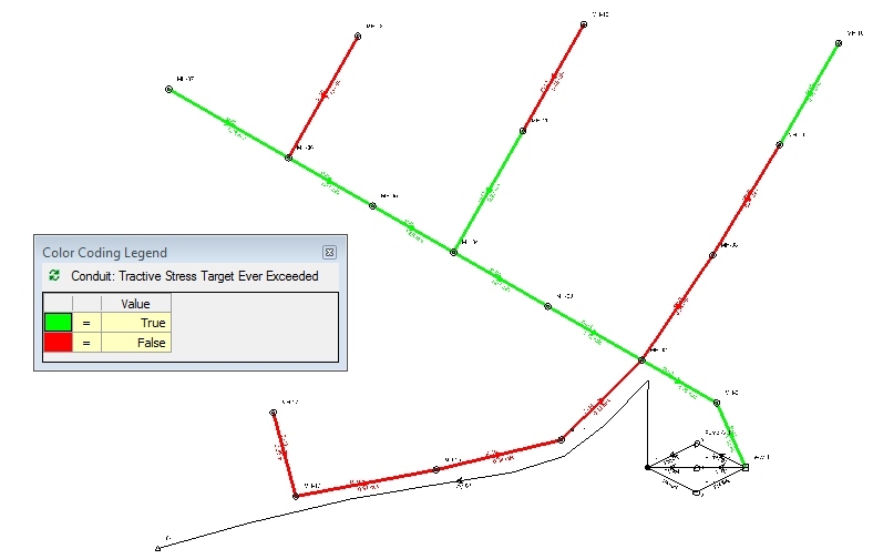

Viewing Results with Color Coding
You can also color code by "tractive stress target exceeded" or "tractive stress target ever exceeded" to visualize:
