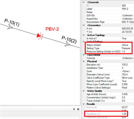

PBV
A Pressure breaker valve (PBV) creates a specified fixed headloss across the valve and is often used to model components that cannot be easily modeled using standard minor loss elements.
To induce a specific headloss (regardless of flow), select "hydraulic grade" as the "Setting Type" and enter the value in length units such as feet or meters of H2O. Or, select "pressure" as the "Setting Type", and enter a specific pressure loss. Note the calculated headloss (in the "Results" section of the properties) matching the headloss setting in the screenshot below.

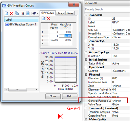

GPV
A GPV defines a rating table of flow versus headloss. For a constant headloss, enter a constant headloss value for the expected range of flow:
