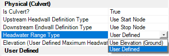

Set the Maximum Headwater Elevation
First, ensure that the maximum headwater elevation is set high enough, to prevent the calculated headwater from being unexpectedly limited.
If you expect that the headwater elevation may extend above the headwall element's ground elevation (the "Elevation (Ground)" in the headwall hydraulic properties), select "User Defined" for the "Headwater Range Type" in the properties of the conduit that represents the culvert. Then, enter the desired maximum headwater elevation in the field "Elevation (User Defined Maximum Headwater)".
By default, the headwater range will be limited by the ground elevation, which can cause results to not appear to match HY-8 if the headwater needs to extend above the ground elevation.

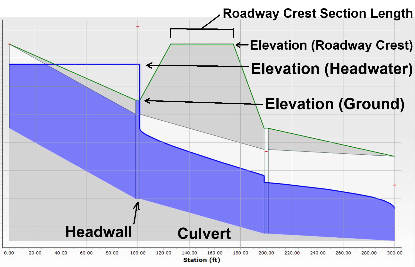

View the Correct Headwater Result
After computing hydraulics, you can find that culvert's headwater elevation in the result field "Elevation (Headwater)" in the properties of the conduit representing the culvert. This shows the water surface elevation on the upstream side of the culvert headwall assuming zero velocity (i.e., equal to the energy grade line), in keeping with HDS-5 / HY-8 methodology:

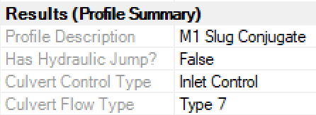

A note on Culvert Control Type - in some situations the "control type" label may not match HY-8 - for example you may see "Outlet Control" when it should be "Inlet Control" (or vice-versa), or in some rare cases it may show as "N/A". The 2026 releases of OpenRoads and OpenFlows Storm/Sewer (expected after April 2026) will address this and provide improved/corrected control type wording. (reference # 2011934)
