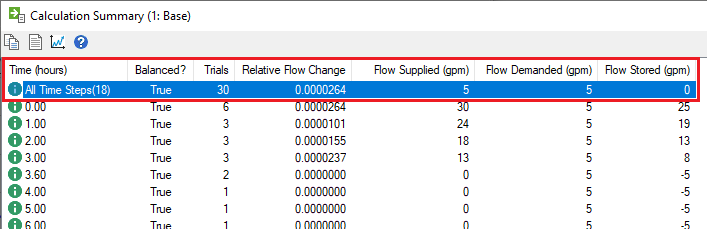

Overall Balance in the "All Time Steps" row
For an Extended Period Simulation, the top row of the Calculation Summary shows "All Time Steps". This represents the average of all reporting timesteps. (all of the time steps displayed in the Calculation Summary, which may be hiding some calculated timesteps) This can also be interpreted as the overall balance, over a period of time.
Note that if you use a constant reporting timestep, there may be calculated timesteps between the reporting times, which will not be included in the calculation of the average value shown in the "All time steps" row. Also, in a model with irregular timesteps (such as a one hour calculation timestep and a few intermediate timesteps inserted at odd times like 13.15 hours), all values are included in the calculation of the average.
For example in a system with reservoirs, demands and tanks, if the volume in the tanks at the end of the simulation is equal to the volume in the tanks at the beginning of the simulation, then the "All time steps" flow stored will be zero while the flow supplied will equal the flow demanded (since the only source of new water comes from reservoirs or negative demands). This also means that in a model with multiple tanks, the "all time steps" flow stored may be close to zero even if some tanks drain and end at a lower elevation, because other other tanks may be filling and ending at a higher elevation.
Note that the "all timesteps" value will be a more accurate overall balance with a smaller timestep. So, if you are using a larger timestep and/or using "constant" reporting timesteps, consider changing the reporting time step to "All" and using a smaller calculation timestep.
