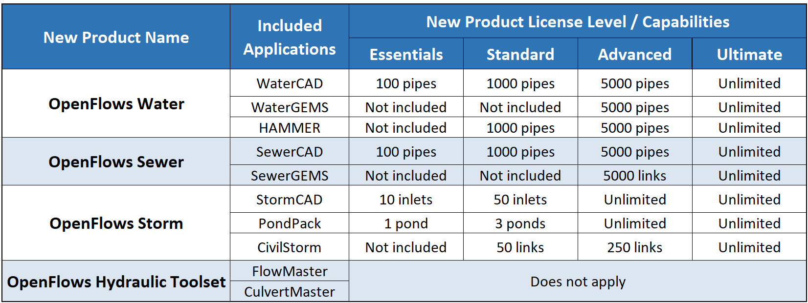

Note: Starting July 1st, 2024, OpenFlows product licenses have been consolidated to a smaller number of packages, simplifying licensing and installation. Please see the following link for more information:
OpenFlows Product Licensing and Feature Levels (New for 2024)
As noted in the above article, the installation files include a suite of applications. For example, OpenFlows Water includes WaterGEMS, WaterCAD, and HAMMER; OpenFlows Sewer includes SewerGEMS and SewerCAD; OpenFlows Storm includes StormCAD and CivilStorm; and OpenFlows Hydraulic Toolset includes FlowMaster and CulvertMaster. How the applications are installed will depend on what you are licensed to use. The section called "OpenFlows 24.00.01.05 and higher Product Installation" in the link above has details on this workflow.
This will not have a significant impact on the license activation through the Feature Level Selector. You will still select the feature level that you own in the Feature Level Selector to activate the license. The chart in the article above, and in the FAQs linked to from the bottom of the next article, explains which feature levels are granted for each tier of the new products.
Note: If you created an entitlement group as a way to limit usage for some feature levels (such as deny access to all un-owned products), you will need to adjust these entitlement groups to use the new packaged OpenFlows product names (OpenFlows Water, OpenFlows Storm, OpenFlows Sewer, or OpenFlows Hydraulic Toolset). You will also need to adjust concurrent use alerts, making note that multiple previous feature levels and products may roll up to a single new OpenFlows product (see the mapping charts in the FAQ articles at the bottom of the following article).

The following table includes the feature levels for the different OpenFlows applications:

WaterCAD and WaterGEMS are licensed by the total number of active pipe elements that you have in a given scenario. For example if you have selected to use a license feature level of 5,000 pipes (from OpenFlows Water Advanced), then you will be able to compute a scenario that has up to 5,000 active pipes in the model. If there are more than 5,000 active pipes in the model, you will not be able to compute. Only the pipe elements are counted (which are connected between node elements such as junctions, pumps, tanks, etc) - lateral link elements are not currently counted. Here are some related articles:
