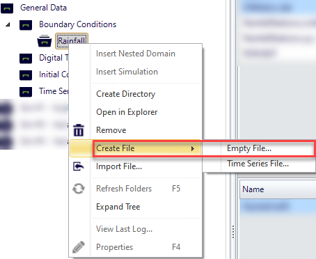

Then select the created folder, right-click and select Create File -> Empty file.
Save the file in the folder as FillMatrix.dat.

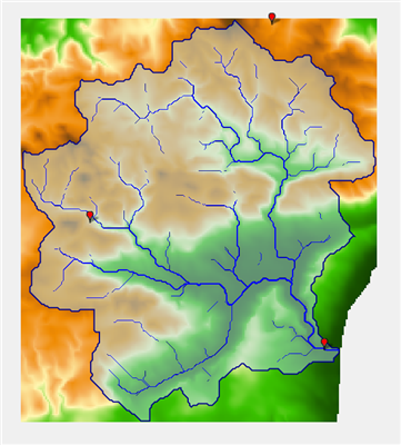

The rainfall gauge positions don't have to be inside the computational grid area and should cover as much area as possible.
Here is an example of 3 rain gauges over a catchment.

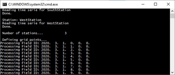

Save the file as RUN.BAT. The file will then be recognized as a batch command file. Double click the file to execute it. A command line dialog as the one below will appear.
At the end a message "Finished..." will appear. Click any key to close the dialog. A HDF5 file will appear on your HDF Files list.

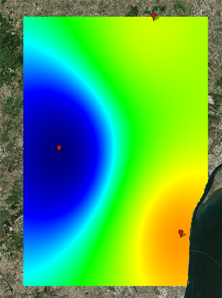

Double click the file to open it in the Map Window. Here is an example of a time frame of the spatially variable rainfall data. The red markers indicate the position of the rainfall gauges.

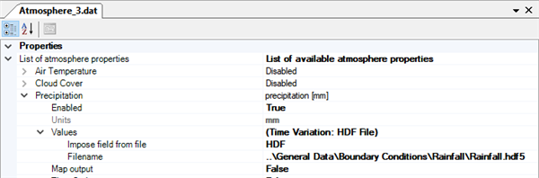

To setup the model to use this rainfall data, go to the Atmosphere module and set the following options:
