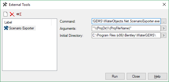

5) Navigate to Tools > Tools > External Tools > Customize External Tools
6) Click the New button, enter a name such as "Scenario Exporter", then populate the fields on the right side as follows:
7) Click the "Close" button.

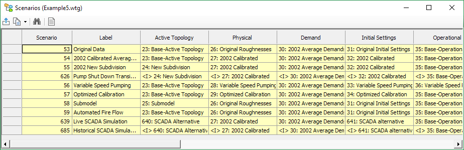

If you configured the tool to produce a tabular view (see "arguments" above), you should see a report similar to the below:
There are several options available at the top of the report:

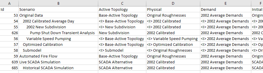

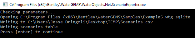

If you configured the tool to produce a CSV file, you will see the following, and the CSV file will be available in the configured folder:
