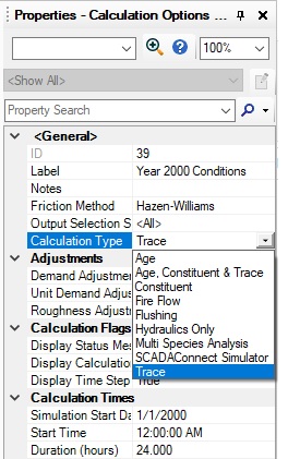

To run a water age, trace or constituent analysis, set the Calculation Type field in the Calculation Options:
By selecting Age, Constituent, or Trace, when you compute a model WaterGEMS and WaterCAD will compute an extended period simulation as well as the type of analysis you have picked. Starting with the CONNECT Edition Update 3, you can calculate all three of the analysis types in a single scenario by choosing the Calculation Type "Age, Constituent, and Trace."
Note that these types of calculations are always extended period simulations, and not available for a steady state run. Details on the different types of runs can be found below.

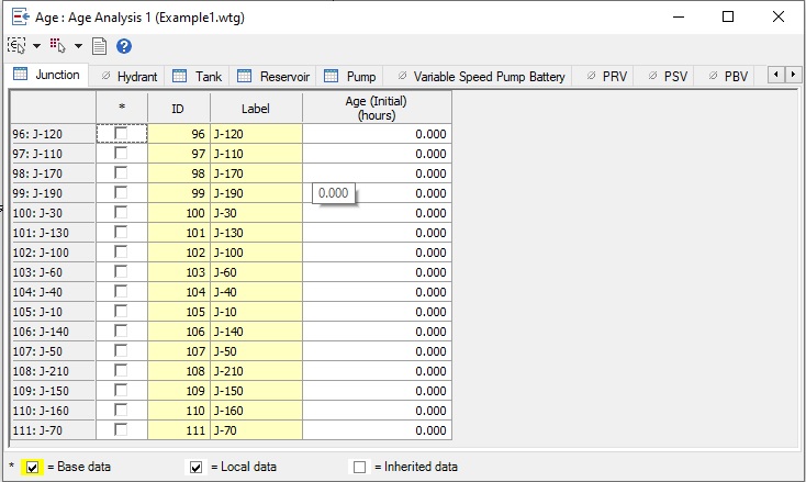

The Age alternative includes the initial water age for nodes in the model. The calculated water age will change for all elements in the model with the exception of reservoirs. The reservoir element is considered a new source of water. The calculated water age at the reservoir will be equal to the initial water age for all time steps.

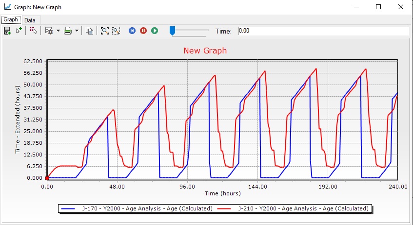

In general, the further from a reservoir a node is, the older the water will be. However, you can see results where demands are being satisfied by a tank if a pump has a status of "Off," such as from a control. In such cases, the water age may increase as a result. An example of this is in the following graph of select nodes in the WaterGEMS sample file Example1.wtg:
Junction J-170 is near a reservoir, adjacent to a pump. Junction J-210 is near the farthest point from the reservoir. While the pump is on, the water age at J-170 is nearly zero and the water age at J-210 is around 6.25 hours. While the pump is on, water is also filling a tank in the system. When the pump turns off, the demands in the system is satisfied from the tank, so the water age is based on the age in the tank, and is higher as a result.
Why do I need to run the simulation for a while in order for results to settle and stabilize?
A typical water age analysis will be for longer than 24 hours, because it will often take longer than 24 hours to reach an equilibrium between flow from a reservoir and flow from tanks. This is primarily due to the fact that the initial age is assumed to be zero by default. Note that you can see this in the graph above as well.

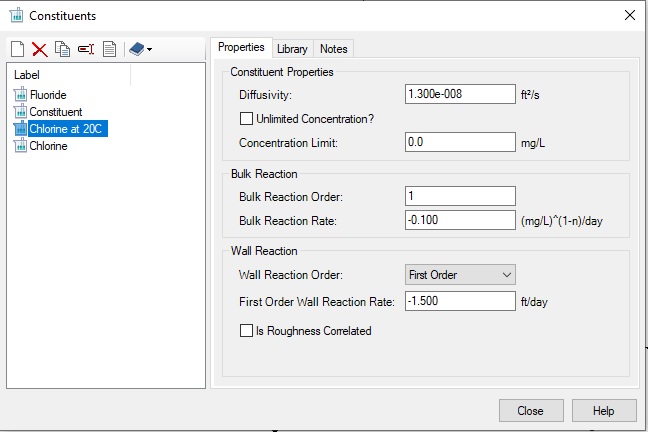

The constituent is defined in the Constituent manager. This is accessed from the Components tab (Components > Other > Water Quality > Constituent).
This is where you define the properties of the constituent, like diffusivity, bulk reaction properties, and wall reaction rate. This information can be added to the engineering library and used in other models.

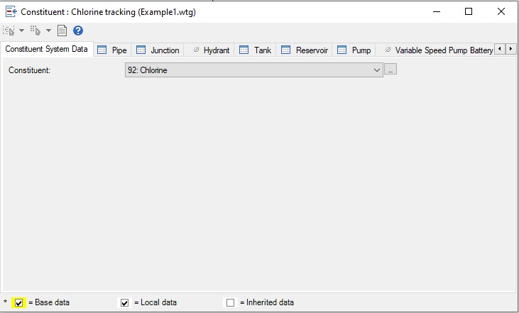

Once the constituent data is added, you would select the constituent in the Constituent alternative. In the Constituent System Data tab, there is a pulldown menu. You can also access the Constituents manager from there by clicking the ellipsis (…) button.

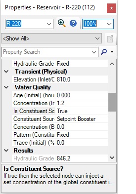

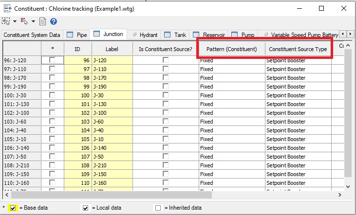

With the constituent created and assigned in the alternative, you can choose a constituent source. If you do this, you have options to enter a constituent pattern and a constituent source type. You can use a constituent source type of Concentration, Flow Paced Booster, Mass Booster, and Setpoint Booster. You can find information on these types here: Understanding Constituent Source Types and Constituent patterns.
It is not required to include a constituent source. If you do not set a source, the constituent concentration will still be calculated in the system based on the properties included in the Constituent properties. In addition, you can also select the constituent source, the constituent source types, and constituent patterns in the Constituent alternative.

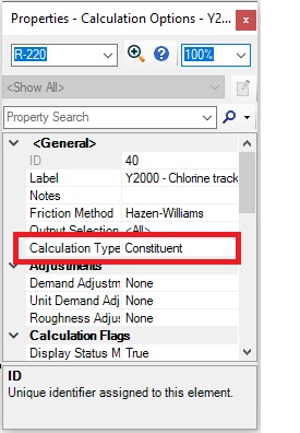

The last thing needed to run a constituent analysis is to set the Calculation Type in the calculation options.

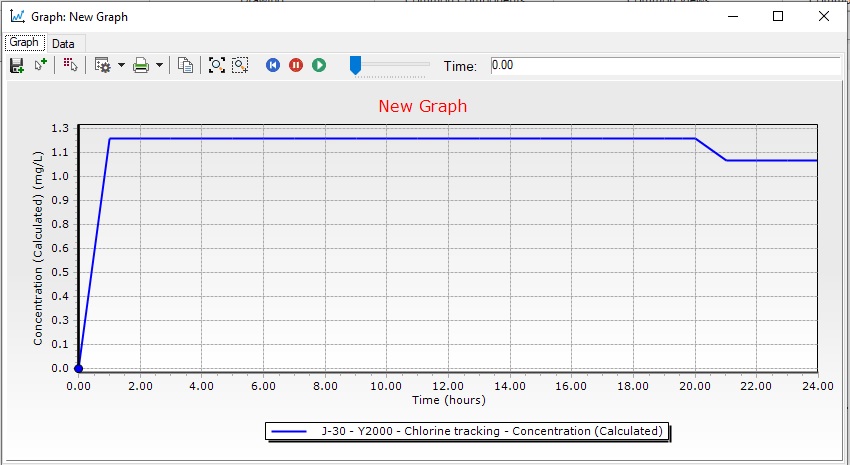

After computing, you can view the constituent results in the properties and FlexTables. Constituent results can vary with time, so you can use the Time Browser to see results at other time steps. You can also view the results in a graph.

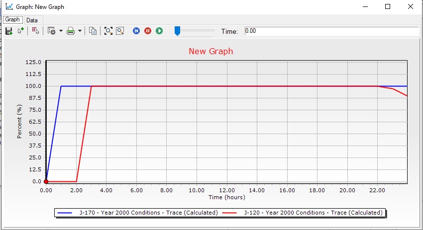

Trace
A trace analysis determines the percentage of the water at all nodes and links in the system in relation to a source node. The source is a specific node in the system assigned in the Trace alternative. Only one trace node can be assigned at a given time. If there is more than one trace node, you can compute multiple trace analyses to calculate the percentage. The Water Quality Batch Run tool could also be used. See the section below for more information.
Note: to trace multiple sources in a single run, see: Using Water Quality Batch run for multi-point trace and multiple constituents

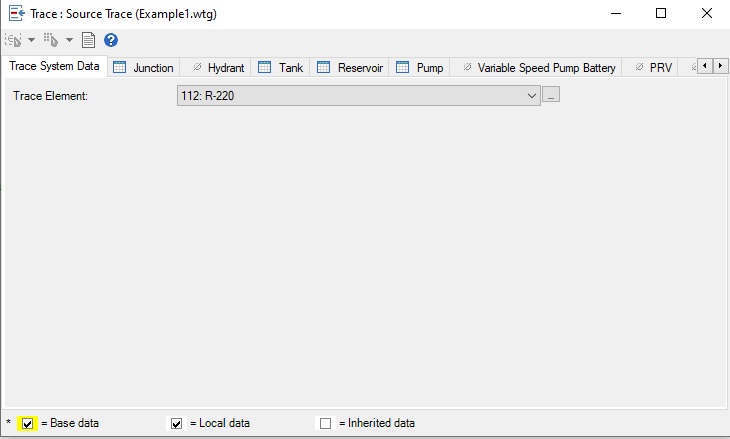

To begin a single source trace analysis, set the trace node you want to use in the Trace alternative:
When you compute the trace analysis, the percentage calculated with be the percentage of flow at that time step to the give element that came from the trace node. The Trace alternative can also be used to define an initial percentage. This initial percentage represents the percentage of water attributable to the trace node at the start of the simulation. This value is also used for the initial percentage for downstream pipes. The default for this is 0%. The initial trace percentage can also be entered in the element properties grid.
Once the Trace alternative is setup, set the Calculation Type in the calculation options to "Trace." When you compute the model, WaterGEMS will calculate the hydraulic solution and then run a trace analysis. Since the trace results will vary with time, you can create a graph to see the trace results or use the Time Browser to move forward to a later time in the simulation.

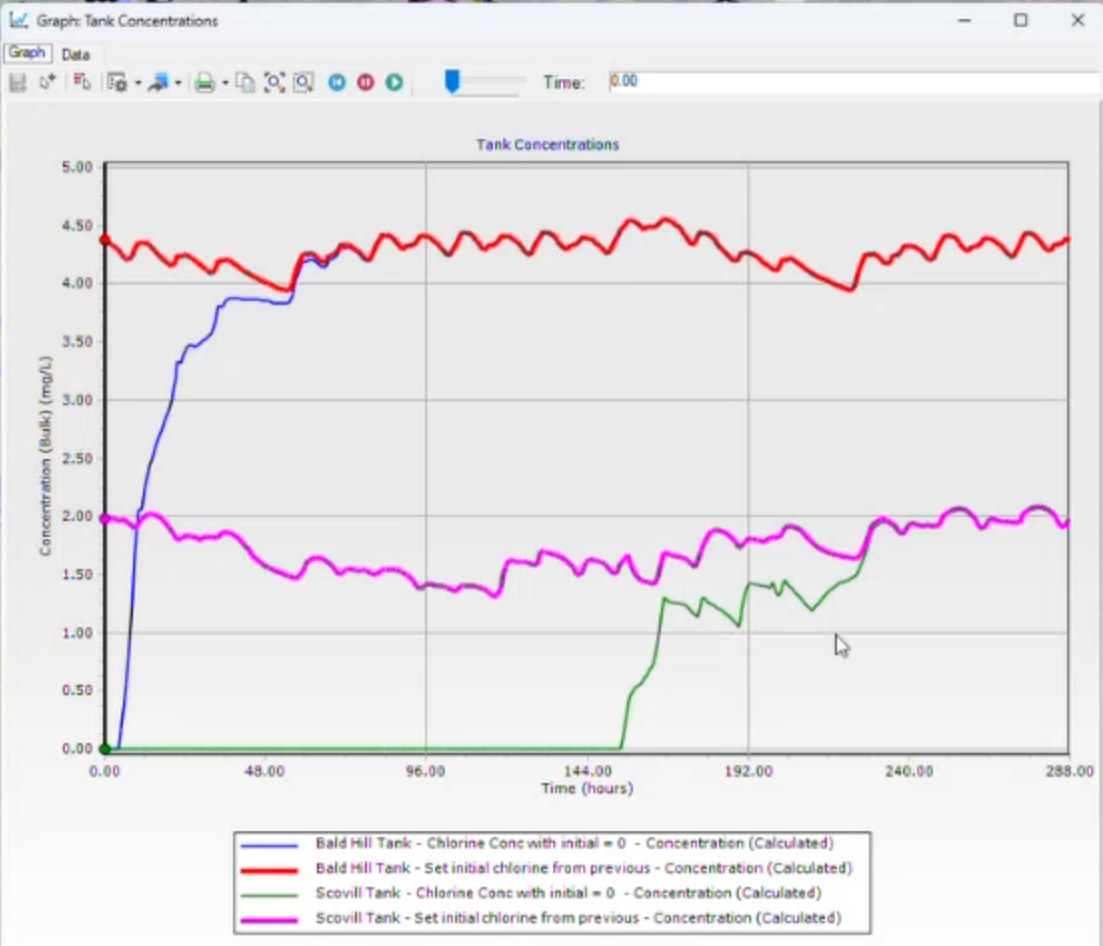

Starting with version 2026 (26.00.00.XXX and higher) you can copy results from a scenario for use as the initial conditions of a water quality run, such as water age, constituent, or trace analysis. This enables you to "prime" or "hot start" a water quality run for example based on the water quality results at the end of a previous run. Doing this enables the subsequent run to balance on reasonable water quality results early in the simulation, potentially preventing the need for long water quality runs that were previously needed in order to achieve such a balanced state.

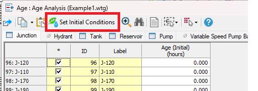

There are multiple ways to access this new feature. First, from the Alternative, you can click the Set Initial Conditions button:

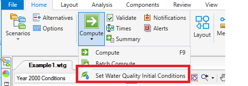

Second, you can click Home > Compute > Set Water Quality Initial Conditions:
With either option, this will open a new dialog where you can either use the current scenario or select another from the pull down menu. Once you click Okay, the program will copy the water quality results for the time step selected to use that the initial water quality input.
The following example graph compares a previous run to a "hot started" run using the new set initial conditions feature. For example the blue line represents concentration for a standard constituent run where you can see it takes multiple days of simulation time to balance on a normal concentration, due to the standard zero initial concentration. The red line shows a subsequent run where the new Set Water Quality Initial Conditions feature has been used to set the initial concentration based on the concentration at the end of a previous run. Notice how this enables it to "balance" right away:
