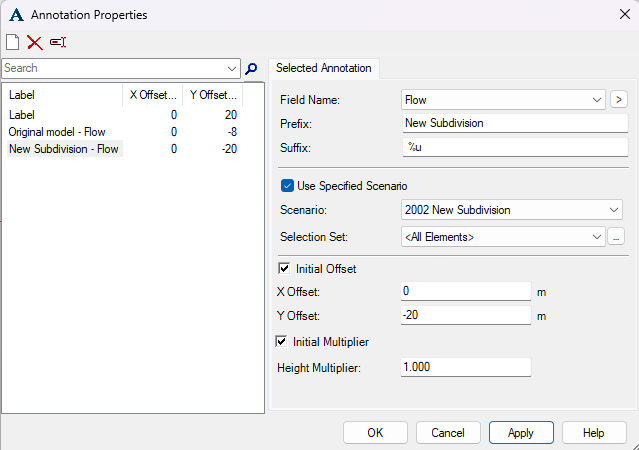

Starting with version 2026 (26.00.00.XXX and higher), you can compare input or output (results) between scenarios using annotations. This enables you to easily compare results between two scenarios in a single drawing. When you create or edit an annotation in Element Symbology, there is an option to select a scenario:

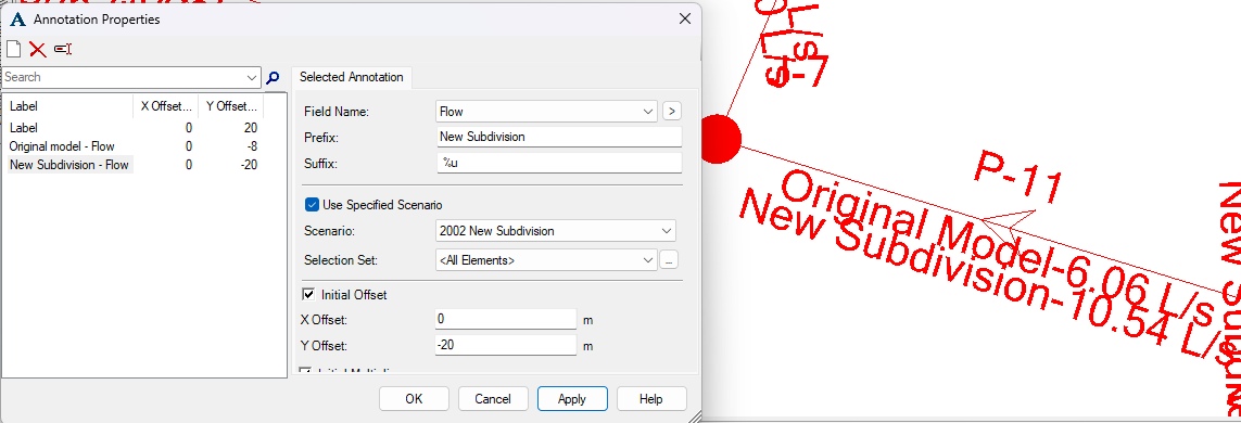

If you create another annotation for the same property field, you can select another scenario to display the results. In the screenshot below, you can see the flow results at a pipe for two different scenarios. Prefixes were used to help differentiate between the results.
See more here: How do I annotate model elements?

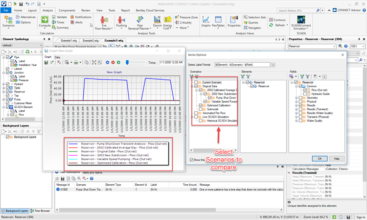

Graphs, Data tables and Profiles
Graph or profile the desired elements together and select the desired scenarios in the Graph Series Options. You can also click the Data tab to see the results in tabular form, which can be copy/pasted to Excel if needed.

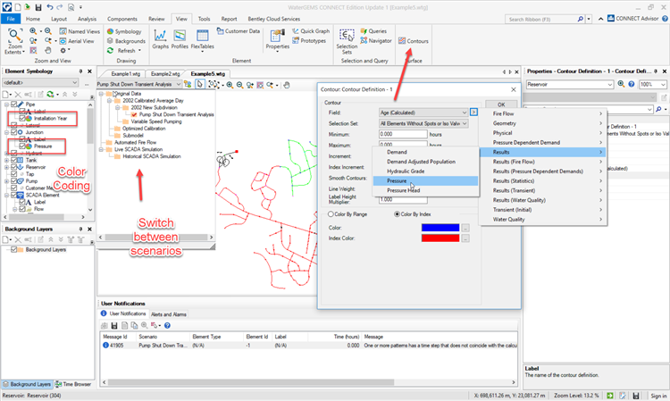

Color Coding or Contours
Set up color coding or contours for the desired result field, then switch back and forth between the scenarios.
