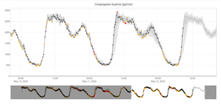

Sensor details shows a detailed chart for a specific sensor. By default the a 3 month signal history will be read.
The chart displays initially a time-window of 2.5 days back into past to 12 hours into future with the range-slider below the main graph turned on. This view is particularly useful to monitor network parameters and to easily spot any anomalies (that can represent bursts, leaks, tank overflows, pressure problems, maintenance works, etc.) in real time. The pattern confidence bands are represented by a grey band, while real (re-sampled) values are represented as a black, red or orange circles. Whenever real data (re-sampled) goes outside the pattern confidence bands (above percentile 95 or below percentile 5 of the pattern), an outlier is identified and the real value is color coded with a red circle. The user has also the option to navigate in the time history series to understand past behaviors or have access to future expected behavior (short-term forecasts), by moving the range-slider below the main graph.

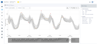

Editing the event
The event can also be edited after creation, such as the duration and other fields, by directly clicking in the event symbol, to access the event detail graph - workflow 1. In that case update the event by using the side panel, image below.
Another workflow is to go the active Events list and search for the specific event and manage from there. Please note that if the event was created with the status closed, you will need to specifically filter for the closed events in the active Event list.

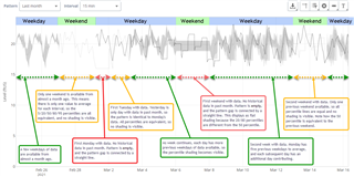

Note: When a sensor is recovering from a long period without data, the first few weeks may have patterns that do not look intuitive. Factors to consider when interpreting patterns include:
Figure 3 - Special case when very few historical data is available.
