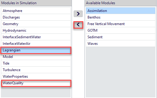

To implement a BOD dispersion simulation, you must first implement, run and validate your hydrodynamic model. Then to activate the Lagrangian module, go to the Model input options and set the "Enable Lagragian Module" to True.
Then in your simulation properties (select simulation, right-click and select Properties), and add the Lagrangian and WaterQuality modules to the left hand-side list of Modules in Simulation.
