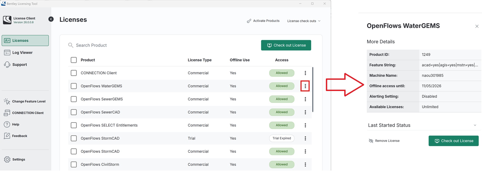

A typical feature string looks similar to this (using WaterGEMS as an example): acad=yes|agis=yes|mstn=yes|pipe=250. Care must be taken to set the correct feature string with the items in the order that matches what is in your entitlements. To confirm, open the "Licenses" tab from Bentley Licensing Tool and check the details of a specific license by clicking in the three dots.

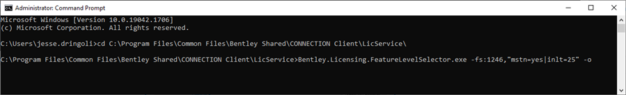

For example if you would like to set StormCAD to use the 25 inlet license without AutoCAD (see screenshot above), regardless of any previous setting, the syntax would be:
Bentley.Licensing.FeatureLevelSelector.exe -fs:1246,"mstn=yes|inlt=25" -o
When this command is run, the license database file will be updated to the desired feature level and when the product is open on the same user account. This can be confirmed by opening the Feature Level Selector.
