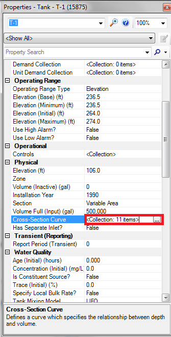

How to I resolve a red user notification that says,  "Post engine loading process encountering unexpected data. Please rectify any validation errors and try again."?
Check your tank "section" property and if it's set to "Variable Area" double check that your "Cross-Section curve' has all the points in it. You can do this by clicking on the ellipsis button found to the right of this collection field.
Or check any Pump Definitions for duplicate entries for Flow and/or Head values.
If you find duplicate entries, just remove one of them and run Validate or Compute your model to see if the message is resolved.
