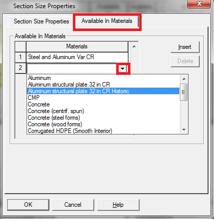

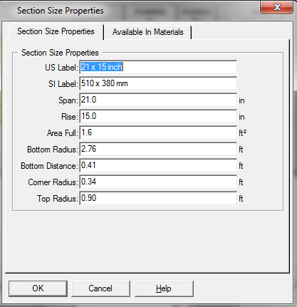

3. Adjust the section size properties on this tab
4. Adjust the material properties on this tab. You can add or remove materials. Materials are added using the drop down menu and the 'Insert' button and removed using the ''
5. When done use the 'Close' button to close the dialog boxes

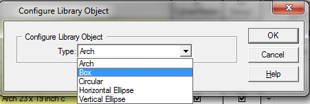

1. Click the "Insert" button
2. Choose the section type

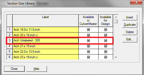

3. Locate the new entry in the list then click the 'Edit' button.
4. You'll be presented with the dialog from steps 3 and 4 from the editing section located above to add in the new section
