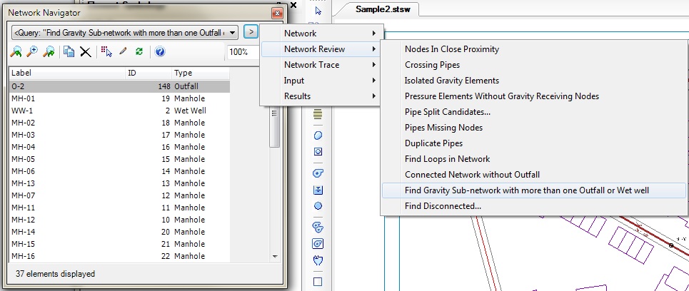

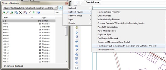

You can visually search for where these situations are occurring in the model. Another option is to use Network Navigator queries. If you are using SewerCAD, to use Network Navigator, go to View > Network Navigator. Select the ">" button and choose Network Review > Find Gravity Sub-network with more than one Outfall or Wet well.
Note: If you are using SewerGEMS or CivilStorm, this query is located under the Network Trace menu in Network Navigator. If you're using SewerGEMS and do not see this query, you will need to upgrade to a later version in order to access (08.11.05.58 or greater) . Previous versions of SewerGEMS do not have this query. This was largely because the Implicit (SewerGEMS) solvers can have multiple outfalls or wet wells, as it uses a dynamic wave solver to solve a network. The other solvers do not allow for multiple outfalls for a single gravity sub-network.
Network Navigator will populate with the elements that have more than one outfall or wet well associated with it. To view these in the drawing, select either the "Highlight" or "Select in Drawing" button. This will help locate the areas where the issue is occurring and allow you to edit the drawing.
