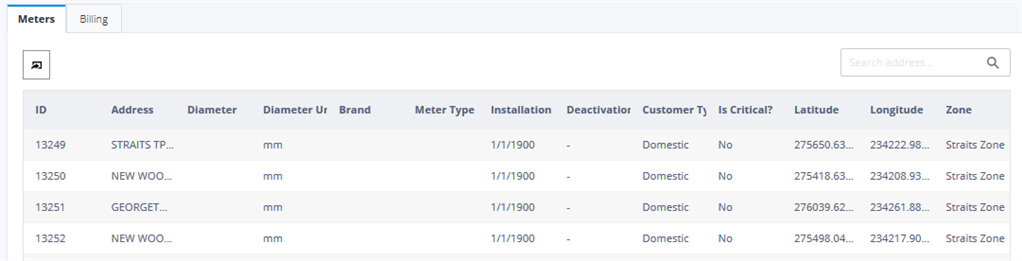

Administration page to upload customer meters characteristics. This information is uploaded trough an excel file, which template is available for download in the Digital Twin Setup page, under Download Templates (Configuration file). The excel tab that must be completed is the one called "Customer Meters", shown in the figure below.
Figure 1 - Template Excel file containing the customer meter information that can be imported to WaterSight.
Meters information should come (at least customer meters ID and geolocation), whenever possible, from the commercial system, to assure that the most up to date information is imported into WaterSight. Information about billings (Customers Billing, inside the administration menu) together with meters geolocation (coordinates or zone) is used to compute the revenue of each zone, used in the water balance diagram. Customer meters fields such as Name, Address, Customer type, Is Critical are also used in the Operational events runs.
Note that the Customers meters list should contain all customers within the water utility, including those that might have smart meters.

Meters Configuration table
Note: Minimum required fields are marked with an asterisk.
Column Description
ID*
Customer meter ID. Must be unique for each meter and must match the ID provided in the monthly billing files. This ID should also match the Billing ID field in the uploaded WaterGEMS hydraulic model, in case customer meter elements exist.
Address The address associated with each customer meter.
Diameter
Diameter of each customer meter
Diameter Units Diameter units of the customer meters
Brand
Brand/Model of the customer meter
Meter Type
Type of meter (example: volumetric, velocity/turbine)
Installation date  Date when the meter was installed.
Deactivation date Date when the meter was deactivated.
Customer type Type of customer. Options available are: domestic, industrial, services, other.
Is Critical Identify which customers are critical (for example an hospital)
Latitude Latitude where the customer meter is installed. The coordinate system should be defined by the user before the upload of the file in the settings. (optional)
Longitude
Longitude where the customer meter is installed. The coordinate system should be defined by the user before the upload of the file in the settings. (optional)
Zone
Only required if coordinates field is not defined. Zone that each customer meter belongs to. The zone name should be the same used in the zones polygon shapefile uploaded in the administration menu, in the GIS page.
