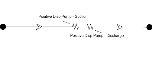

First, you would need to externally determine the flow that would occur out of the pump and compile a table of flow versus time. Then you would use two "periodic head-flow" elements in the model, one representing the suction side and one for the discharge side, with a gap between, as shown below.

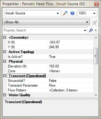

In the Properties display for the Periodic Head-Flow elements, you would set the attribute "Transient Parameter" to Flow. For "Sinusoidal?", choose False.
This will enable you to define the Flow Pattern table for flow versus time. The tables for each will need to be identical, except that the values for flow. On the suction side, the flow values will be positive (outflow). On the discharge side, they will be negative, to represent inflow. This way, you can approximate the correct flow rates and let the head behave as it should based on the system conditions.

A note on profiles: Note that you would need to create two profiles, one for the portion of the network upstream of the pump (from the reservoir to the upstream periodic flow element), and a second one for the downstream portion (from the second periodic flow to the downstream end). Typically you would not see significant transient effects on the suction side, but looking at a second profile of that single pipe will enable you to check this.
