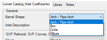

Arch Shaped Culverts
As of the CONNECT Edition, Arch is available as a standard culvert shape. It can be selected in the culvert library and used in conduits whose section shape is set to Arch or Pipe-Arch (as mentioned above, Pipe-Arch must be used as a catalog conduit). In V8i and earlier, arch shaped culverts were not available.
