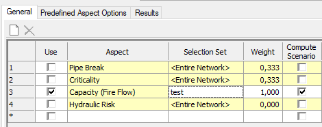

This can be accomplishing using the Pipe Renewal Planner tool. First, ensure the fireflow analysis is properly configured and that you are satisfied with the results (see guidance here).
In Pipe Renewal Planner under Predefined Aspect Options, set up Capacity Score Analysis Options.  Uncheck all the options except Capacity. Set its weight to 1 and run.

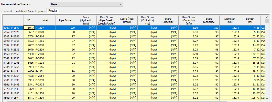

In the Results section, go to the column "Raw Score (Capacity)" (the max velocity in each pipe) right click and choose Sort Descending. You will see then see results with the worst pipes at the top.
