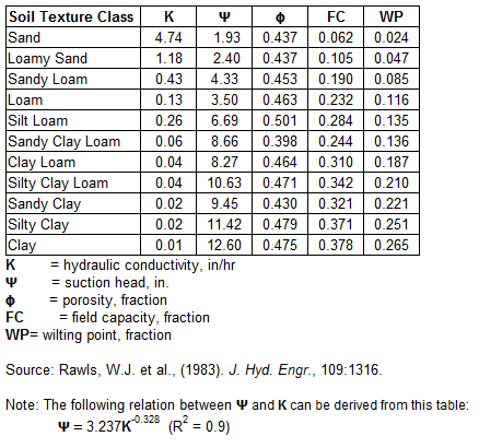

  • Green-Ampt: The Green- Ampt infiltration method is used to compute the pond seepage loss, in which suction head, conductivity and initial deficit data are required.
    • Suction Head: Average value of soil capillary suction along the wetting front (inches or mm)
    • Conductivity: Soil saturated hydraulic conductivity (in/hr or mm/hr)
    • Initial Deficit: Fraction of soil volume that is initially dry (i.e., difference between soil porosity and initial moisture content) The initial deficit for a completely drained soil is the difference between the soil's porosity and its field capacity. Typical values for all of these parameters can be found in the Soil Characteristics Table.
