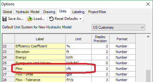

How can I change the units seen in the text output reports when computing a model with the Explicit (SWMM) solver?

Model Flow UnitOutput Report Flow Unit
CMSCMS
MLDMLD
Any other SILPS
GPMGPM
MGDMGD
Any other USCFS
