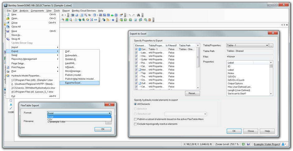

1. Prepare the model.
2. Go to File > Export > Export to Excel
3. Set the export options. Note that these setting will persist for future exports.
Select the element types to export.
This is done in the "Specify Properties to Export" section on the left side. The element types that are checked will be exported as separate tabs in the spreadsheet.
Specify hydraulic model elements to export
Table/Properties
Select an element type and choose to export all properties or just the properties included in an existing FlexTable. This can be selected from the dropdown list or by clicking the ellipses "…" button. This needs to be done separately for each element type. You can create a new custom flextable (under "Hydraulic Model" to save it just in the current model, or "Shared" for it to be available in all models - see more here) to help reduce the amount of data exported.
Table Path
It is possible to have multiple FlexTables with the same name. This field shows if the FlexTable selected is Shared, Predefined, or if it is only contained in the Hydraulic Model.
Filter
If the selected FlexTable is filtered, the filter is displayed in the Filter field and in the left pane, the Is Filtered column is set to True for that element type.
Properties
This shows the properties that are to be exported for that element type. As mentioned above, you can create and select a custom flextable with only the fields you need, to help reduce the exported data.
Specify result time steps to export
This is a new feature available starting with CONNECT Edition Update 4 (10.04.00.XXX and greater). This enables you to filter calculated results for an EPS using a Constant output step, or a Variable output step. With the "variable" option, you can choose between No results, All results or a Constant output step, for multiple time ranges, just like the calculation option described here. Note that this feature applies a filter on top of the existing computed results, and the setting you choose is persisted across all models (be sure to adjust it for other models as needed). For example if you wish to only export hydraulic results for the last 24 hours of a one week simulation, you can use the "Variable" option and set the first 6 days to "None" and then use the "All" or "Constant" for the last 24 hours.
4. After all settings are established for all element types, click OK.
5. Specify the format (Excel or CSV) and the location to save to, then click OK. Note that the Excel (XLSX) format has a limit of 1,048,576 rows.
