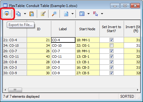

Export from Flextables
The first and most basic method of exporting model results to Excel is to use the Export button in the top-left corner of any Flextable. From here, choose CSV as the file type and the table will be exported to a CSV file that can be opened in Excel. Make sure to add or remove columns as needed before export. You can set up a new Project-Level flextable first if you don't want to modify the predefined flextables.
Note that with this method, calculated / results fields will export the values for the current timestep only. To export all timesteps, see the next method below.

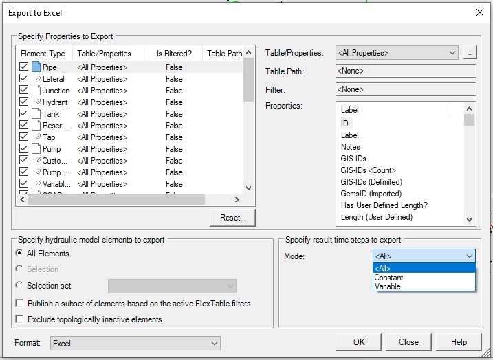

Excel Export from the File Menu
Previously, data could be exported to Excel via the Flextables, but needed to be done one Flextable at a time and did not include time series (results over time). Now, starting with V8i SELECTseries 6 (08.11.06.58+) of WaterCAD, WaterGEMS and HAMMER, and V8i SELECTseries 5 (08.11.05.58+) of SewerGEMS, SewerCAD, StormCAD and CivilStorm, we have added the ability to export data for all the element types at once, including time series.
See also: Export time series data to Excel or CSV format
The following are the steps to use this:
Go to File > Export > Export to Excel
Next, in the Export to Excel dialog, specify properties and elements to be exported by clicking the check boxes. Click OK. Note: these settings will be saved for the next export
In the FlexTable Export dialog, select either Excel or CSV format and specify where it will be exported. On the lower left side of the dialog box you can also choose to export all elements, elements by a selection set, exclude inactive elements, or publish a subset of elements based on the active Flextable filters. Click OK.

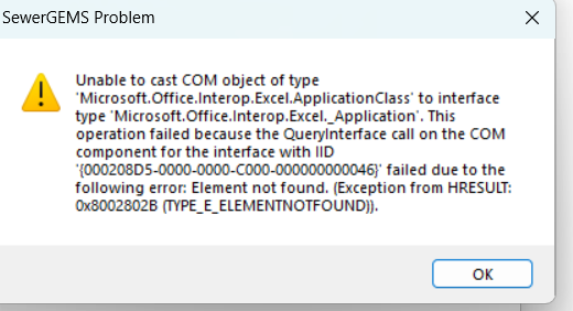

Error During Export to Microsoft Excel: COM/Interop Interface Failure
Symptoms
When attempting to export data from an OpenFlows standalone product (WaterGEMS, WaterCAD, SewerGEMS, SewerCAD, HAMMER, CivilStorm, StormCAD, etc.) to Microsoft Excel, the export fails and an error similar to the following is displayed:
Unable to cast COM object of type 'Microsoft.Office.Interop.Excel.ApplicationClass' to interface type 'Microsoft.Office.Interop.Excel._Application'. This operation failed because the QueryInterface call on the COM component for the interface with IID '{000208D5-0000-0000-C000-000000000046}' failed due to the following error: Element not found. (Exception from HRESULT: 0x8002802B (TYPE_E_ELEMENTNOTFOUND)).
Cause
This error is typically caused by a Microsoft Office COM registration issue rather than a problem within OpenFlows itself. Common causes include:
- Missing, invalid, or corrupted Microsoft Office registry entries.
- A recent Microsoft Office or Windows update that affected communication between Excel and external applications.
- Damaged Microsoft Office installation files.
- COM automation registration issues preventing OpenFlows from creating or communicating with an Excel instance.
Resolution

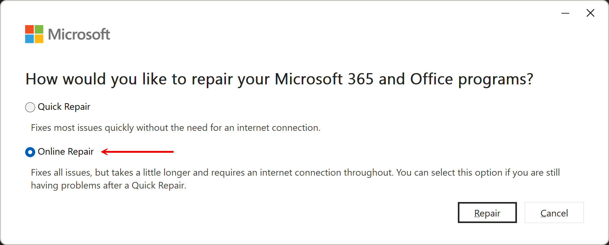

Option 1: Repair Microsoft Office (Recommended)
Perform an Online Repair of Microsoft Office to restore Excel COM registrations and related components.
- Close OpenFlows and Microsoft Excel.
- Open Control Panel > Programs and Features.
- Locate Microsoft Office or Microsoft 365 Apps.
- Select Change or Modify.
- Choose Online Repair.
- Complete the repair process.
Important: Use Online Repair rather than Quick Repair, as Online Repair performs a more comprehensive repair and can resolve registry and COM-related issues.
- Restart the computer.
- Launch OpenFlows and test the Excel export again.
If the export succeeds after the Office repair, no further action is required.

Export FlexTables to CSV or Text Format
- Open the desired FlexTable.
- Select Export from the FlexTable toolbar.
- Change the output format to Text File (*.csv) or Text File (*.txt).
- Save the file.
- Open the exported file directly in Microsoft Excel if required.
Since CSV and TXT exports do not rely on Excel COM automation, they bypass the communication issue between OpenFlows and Microsoft Excel entirely.
