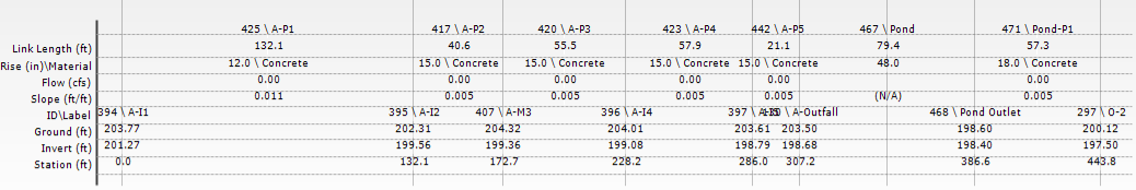

In both the regular hydraulic profile and in the engineering profile, you can click the options button in the top-left corner and choose to export to DXF. If the annotation table was displayed, it will be included in the exported DXF file.
Option 2: Chart Options
For hydraulic profiles (the one that appears when double clicking on the profile name, not to be confused with Engineering Profiles), to access the data table that stores the information in the profile annotation table, click the Options button in the top-left corner and choose "Chart Options". In the Chart Options dialog, select the Export tab, then choose the "Data" sub-tab. For the "Series" dropdown box select either "Annotation Table" or "Annotation Table Labels", choose the export file type (such as Excel) and then click Save. The data will be exported.
To preview this data before export, select Annotation Table from the Series tab, then click the Data tab.

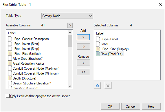

1) First, create a new combined pipe/node flextable with the desired fields. From the View menu, select Flextable (to open the Flextable manager), then right click on either "Tables - Hydraulic Model" (for a table that will only be available for the current model) or "Tables - Shared" (for a table that will be available for all models on the current computer), choose New > Node-Connected Pipe Flextable, or "2 row FlexTable" (see the Help documentation for the differences)
Note: for StormCAD, you can also choose to open the predefined table called "DOT Report" which is a 2-Row Flextable.
2) In the Flextable options dialog that appears, choose "gravity node" as the Table Type (for the "Pipe-Connected Node" type) or "Conduit" (for the 2-Row type), then add the desired fields to the right side. Note that a limited set of fields may be available depending on the Flextable type.

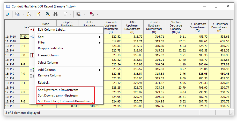

5) In the Flextable, right click one of the column headers and choose to "Sort Upstream-> Downstream", "Sort Downstream-> Upstream" or "Sort Dendritic"
6) Modify the table as needed and generate a report, export or copy/paste externally as needed.
