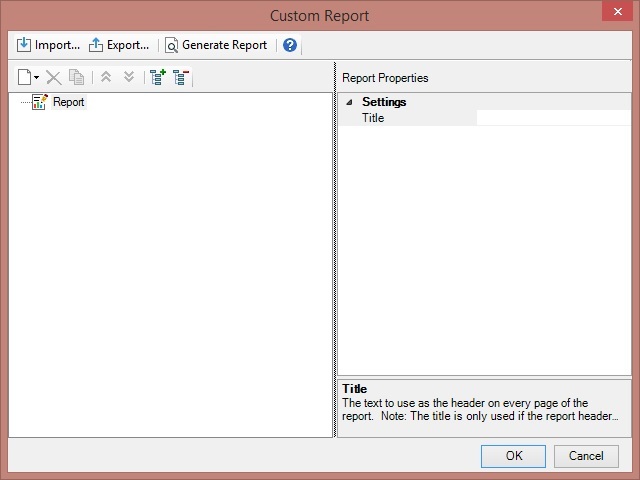

You can choose the Custom Report option from the Report menu in the ribbon.
This will open a new dialog used to create Custom Reports.

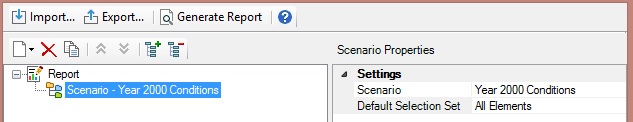

To begin, click the New button in the upper left and choose Scenario. This will add an item to the list on the left. You will then need to select a scenario that the report will be generated from. You will also need to choose a Selection Set. NOTE: Choosing a selection set is required. If you don't have a selection set, you can create one by highlighting all elements in the model, then right-clicking anywhere in the drawing, and choosing Create Selection Set.
Once the scenario and selection set is created, you can then set up the report how you like. Items that you can add include graphs and data tables, flextables, and views. You can also add page breaks and line breaks, and insert reports that are already available, such as the Scenario Summary Report. To see the available items, right-click on Scenario on the left of the Custom Report dialog. The sections below will briefly touch on some of these features.

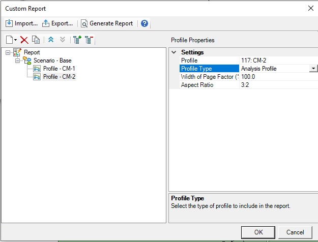

Profiles

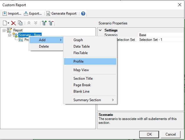

Starting with the CONNECT Edition Update 3 release of the storm-sewer products (build 10.03.01.08), you can now add profiles to custom reports. To add a profile, either right-click on the scenario from the tree-form or click the New Sections button, then choose Profile. You will choose an existing profile and the profile type (Analysis Profile or Engineering Profile). The profile will then be included in the custom report.
If you have older versions of the storm-sewer products or WaterGEMS/WaterCAD, and you need to include a profile, you can copy the profile by clicking on the copy button situated at the top of the profile window.
The captured profile can then be pasted directly in a report or saved as an image for future use. The profile can also be exported as a DXF if it needs to be included as a drawing to a report. The "Export to DXF" option appears in the pulldown menu by clicking on the Chart Settings in the top left corner of the window.

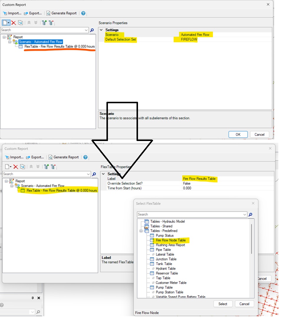

FlexTables

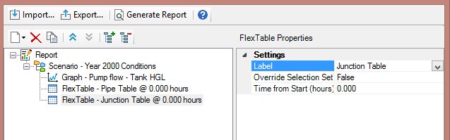

The element FlexTables are a key method for viewing results. You can create reports directly from the FlexTables. With the Custom Reports, it is now possible to report the data from more than one FlexTable on the same report.
To add FlexTables to the Custom Report, right-click on the scenario on the left of the dialog and choose Add > FlexTable. On the right side of the dialog, choose the FlexTable you want to use by select the Label selection. By choosing Select FlexTable, the FlexTable manager will open and allow you to choose the FlexTable you want to use. Once you do this, you can also select the time step that you want to use for the Custom Report.
You can include as many FlexTables as you like. They will need to be added individually. You may want to edit the FlexTables to add or remove properties that are displayed. To do this, follow the steps in the following link: Customizing FlexTables for viewing and reporting data -- Moving, adding, and removing columns.

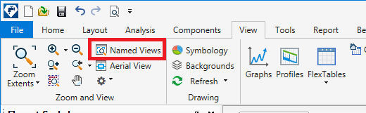

Named Views

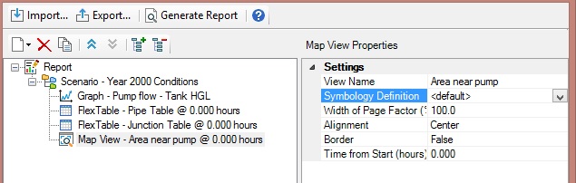

Named Views allows you to zoom directly to certain parts of the model quickly. For instance, if you want to save a view near a pump, but do not want to use the Zoom functions to constantly go back and forth between the view of the pump and the whole model, Named Views can be very useful. To use this, go to the View tab and choose Named Views.
In the Named Views dialog, you can add a view by clicking the New button. You can then use the zoom functions to and panning tool to have the drawing pane display what you want to see. You can then click the Update Named View in the Named View dialog to update the selected view to show what is currently in the drawing pane. If you zoom back out to the full extent of the model and double-click on the named view, the drawing pane will display the view assigned to it.
To add a Named View to the Custom Report, right-click on the scenario on the right side of the dialog and choose Add > Map View. You can then select the Named View by choosing the "Select Named View" option in the View Name selection. If you are using symbology definitions, you can also choose how you want your element symbology to be displayed.

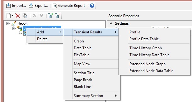

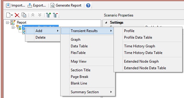

Custom Reports in HAMMER
Custom Reports are available in HAMMER as well, and include the transient profiles, time history results, and extended node data that are available in the Transient Results Viewer. You have the ability to include the not just the graphical results, but the numerical results as well. For instance, you can include the Time History graph or the Time History data table (or both).
