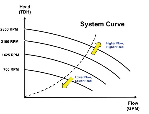

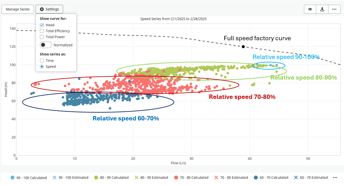

Variable Speed Pumps
Variable speed pumps can change the shape of the Head Curve by operating a reduced speed. This allows behavior such as operating at a fixed flow rate over a range of head conditions, or adjust the flow rate to maintain a constant downstream pressure. Variable speed pumps are often able to reduce energy costs by consistently operating near the best efficiency point over a range of conditions, or by reducing the flow rate without requiring throttling valves that waste energy.
For variable speed pumps the effective head curve that the pump operates on is variable and depending on the pump speed, as shown below.
In WaterSight only the full speed factory curve is displayed (in example above it would correspond to the pump curve for the speed = 2850 RPM), therefore most of the time the pump operating points will not align with the full speed Factory Curve even when the pump is in good condition, because the pump might be operating at lower speeds. The points may display in a horizontal line underneath the full speed curve (indicating a fixed head setpoint), or a vertical line under the curve (indicating a fixed flow setpoint), or some other pattern.

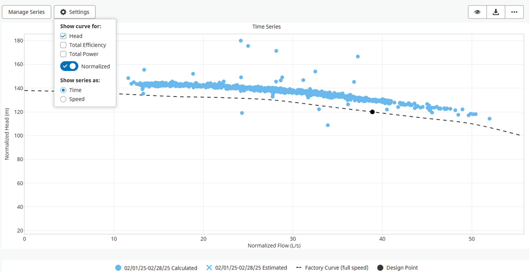

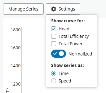

In order to evaluate whether the pump is in good condition, the actual operating points can be normalized using the Pump Affinity Laws to show what the flow and head would be if the pump was operating at full speed. This requires a Speed signal and the full speed value to be configured in the Pump Configuration page. Use the Normalized option to toggle between normalized and normal display. This option is only available for Variable Speed Pumps (note: if this option is not displayed make sure that in the administration the pump is set to variable speed pump).

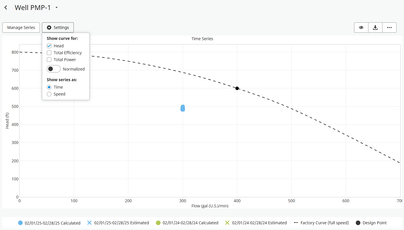

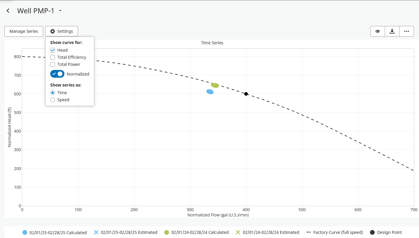

In the example below, two series for the pump have been defined. Each is for the month of February, one year apart.
With the normal display showing the actual flow and head (graph on the left), we see a vertical line indicating the pump is holding a constant 300 gpm over a range of head conditions. The points look the same for both years. The points are well below the factory curve, but for a Variable Speed Pump that does not indicate the condition of the pump. Under the normalized view (graph on the right), it can be seen that under full speed the pump would be operating below the Factory Curve, and that of the condition of the pump has degraded over the course of the year. Although the degradation in pump condition has not yet impacted the observed performance, it may be worth performing preventative maintenance and identifying the cause of the issue.

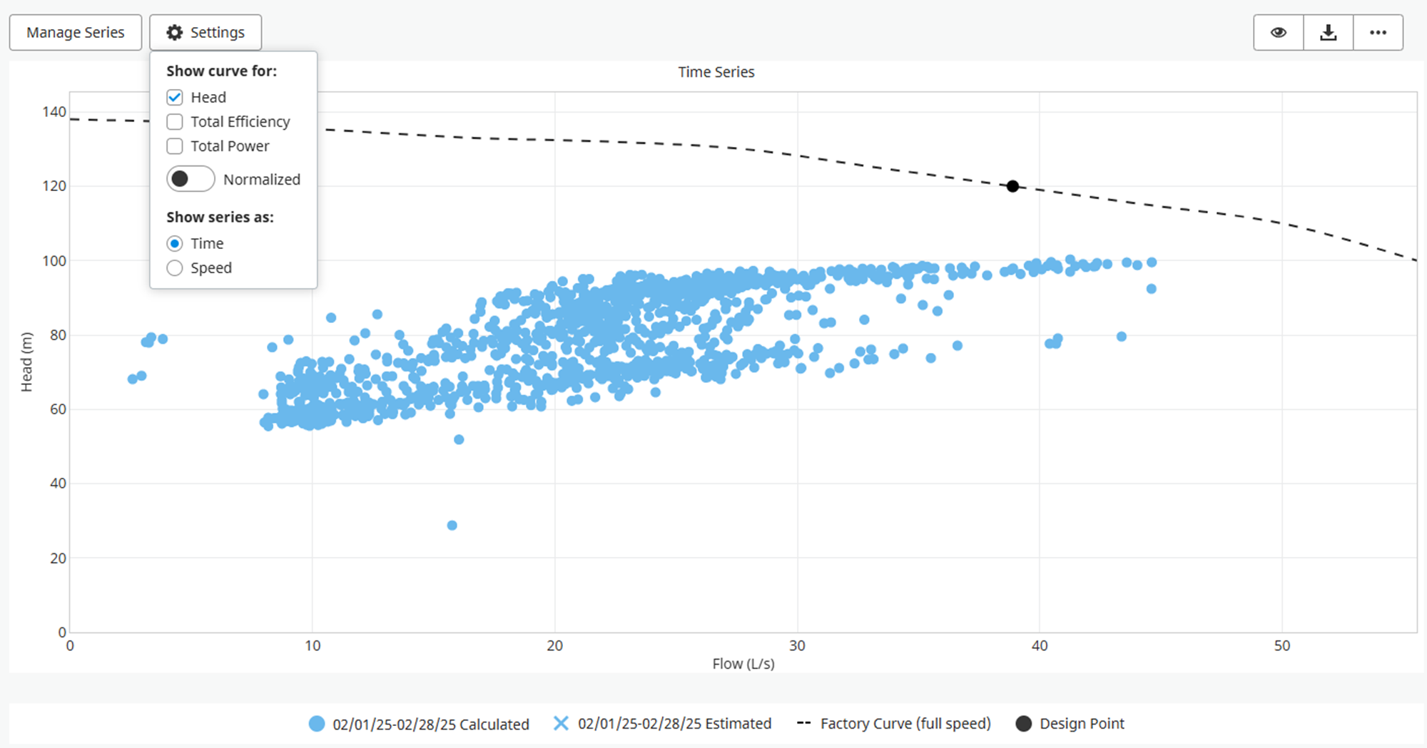

Another example below for another variable speed pump. On the left showing the actual operating points compared with the full speed curve (on the left) and on the right using the normalized option to display the operating points as if they were operating at full speed.
To check the real operating points for each pump speed, the user should disable the normalized option and select the option "Speed" under "Show series as". Example below shows the different actual operating points for the different relative speeds.
