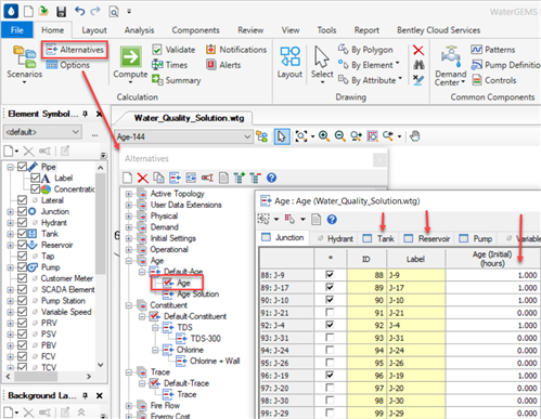

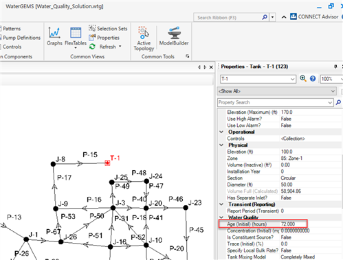

Initial water age can be defined at reservoirs, tanks or junctions through age alternative. Analysis > Alternatives > Age > Enter age (Initial) for tank or reservoirs here. You can enter the age for junctions / tanks individually or right click on the Age (Initial) column > Global Edit > Set the value. Initial water age then will appear in element properties.

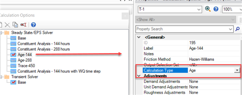

Before computing age scenario be sure, to change the calculation type to Age in calculation options.

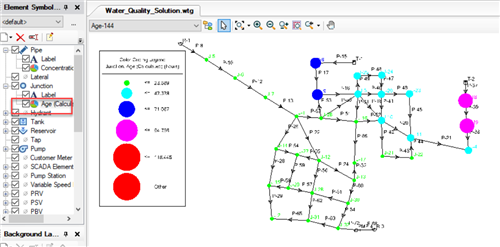

After computing the age analysis scenario it is recommended to use color coding to observe the age results visually.

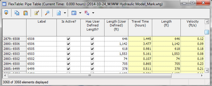

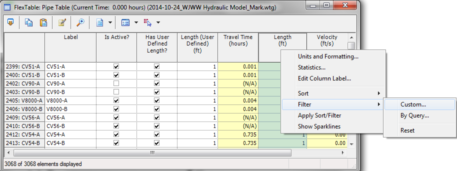

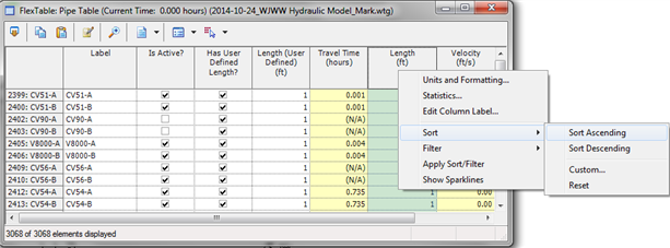

1) Open your pipes flextable and edit it to add the following fields:  a) Is Active?  b) Has user defined length?  c) Length (user defined)  d) Travel Time (This is the length of the pipe divided by the velocity)  e) Length f) Velocity
*If you're not familiar with how to edit a flextable please refer the help documentation that comes with the software and look for the document titled "Editing Flextables"

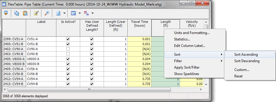

2) After determining if your pipes have a user defined length or scaled length, right click on the appropriate column header, and choose  Sort > Ascending. This will bring the shortest pipes to the top of the table.

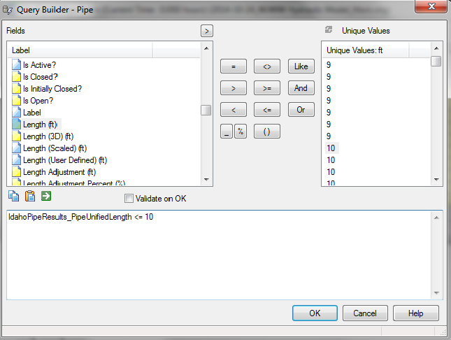

Look at those to see if there are any short pipes, which could be considered any pipe under 10 ft. (3.05 m) for this first round of troubleshooting. An easy way to do this is to use a custom query filter on the "Length" column. This can be done by right clicking the appropriate column header and choosing Filter > Custom.
Your query should have the following syntax: (This example assumes that your model uses scaled lengths)
IdahoPipeResults_PipeUnifiedLength <= 10
If you aren't familiar with how to a create custom query you can have a look at this wiki, which explains a few ways to filer a flextable based on a custom query:
https://communities.bentley.com/products/hydraulics___hydrology/w/hydraulics_and_hydrology__wiki/how-to-globally-edit-certain-elements-in-an-element-flextable
3) Once filtered locate your "Travel Time" column and if necessary change the units to minutes in order to make it easier to understand. The following wiki will show you a few ways to do that if you are unfamiliar with it:
 https://bentleysystems.service-now.com/community?id=kb_article_view&sysparm_article=KB0014604
Just as in step 2 sort this column in ascending order and look for pipes with very short travel times (< 30 seconds). The reason we are looking for pipes with short travel times is because these pipes can potentially impact the water age calculation. Too short a travel time can make a graph of the water age in pipes or tanks look like it is increasing exponentially.
