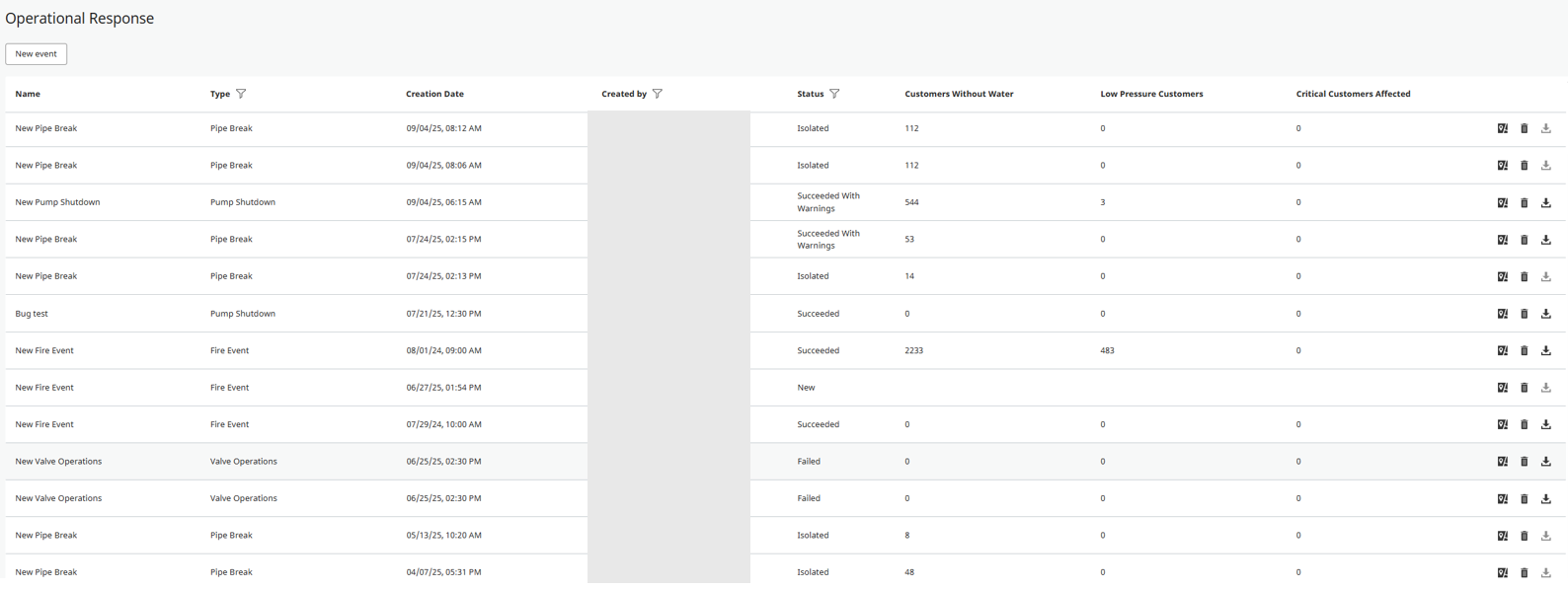

The operational event page goal is to assess and demonstrate the impact of operational events (such as pipe breaks, fire events and pump shutdowns) to service levels, including the details of the customers affected (with no water and low pressures).

Once an event is created, the user will automatically be redirected to a map to set the location of the event. The operational event is automatically saved in the Operational Events table (below the New event button) after a location for the event is defined.
Name
User defined name assigned to the event. This field can be changed in the event editor page. To accede the event editor page, click on the map icon   located on the right side of the table (last column).
Type
The type of event selected from the "New Event" drop down button, that was used to create the record. This field is automatically populated and can't be changed.
Creation Date
Time when the event record was created by the user. This field is automatically populated and can't be changed.
Created by
The email of the user that created the event record. This field is automatically populated and can't be changed.
Status
Indicates the status of the event simulation. This field is automatically populated and updated and can't be changed.
Status Type Description
Preparing All Model computation about to start
Isolating Pipe break Topological analysis in progress to determine affected customers (no hydraulic model computation required)
Isolated Pipe break Results from topological analysis are available (no hydraulic model computation required)
In Progress All Model computation in progress
Succeeded All Model computation completed successfully; results are available for review
Failed All Model computation failed; results are unavailable
