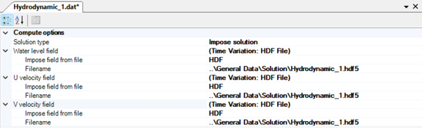

To read a pre-computed hydrodynamic solution go the Hydrodynamic model and set the following options:
Alternatively, you can use the text editor options as shown below:
EVOLUTION                         : Imposed Solution
<begin_waterlevel>
UNITS                                   : m
DIMENSION                         : 2D
DEFAULTVALUE                  : 0
FILE_IN_TIME                      : HDF
FILENAME                            : ..\General Data\Solution\Hydrodynamic_1.hdf5
<end_waterlevel>
<begin_velocity_u>
UNITS                                   : m/s
DIMENSION                         : 2D
DEFAULTVALUE                  : 0
FILE_IN_TIME                      : HDF
<end_velocity_u>
<begin_velocity_v>
UNITS                                   : m/s
DIMENSION                         : 2D
DEFAULTVALUE                  : 0
FILE_IN_TIME                      : HDF
<end_velocity_v>
