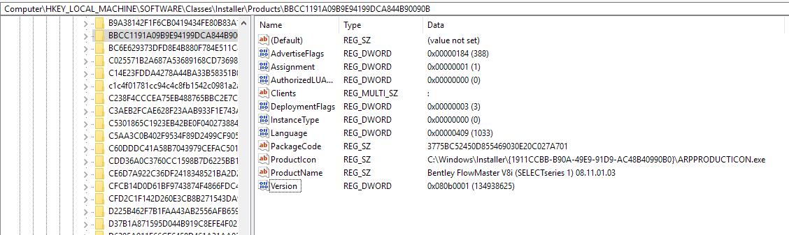

3) If you are following these steps because of an installation issue, remove the following location (folder) from the Windows registry. See further below under "licensing cleanup" for more on using Regedit.
HKEY_LOCAL_MACHINE\SOFTWARE\Classes\Installer\Products\<unique ID for product>
Where "<unique ID for product" is a unique set of characters where the installation information about the product is located. To find this, navigate to the root folder (up to "\Products\") and perform a search for the product name. FlowMaster is used an example in the screenshot below:
Please note that any changes made to the registry are permanent, so it's advisable that you speak to your IT professional when trying the steps below or make sure to back up your registry before hand.

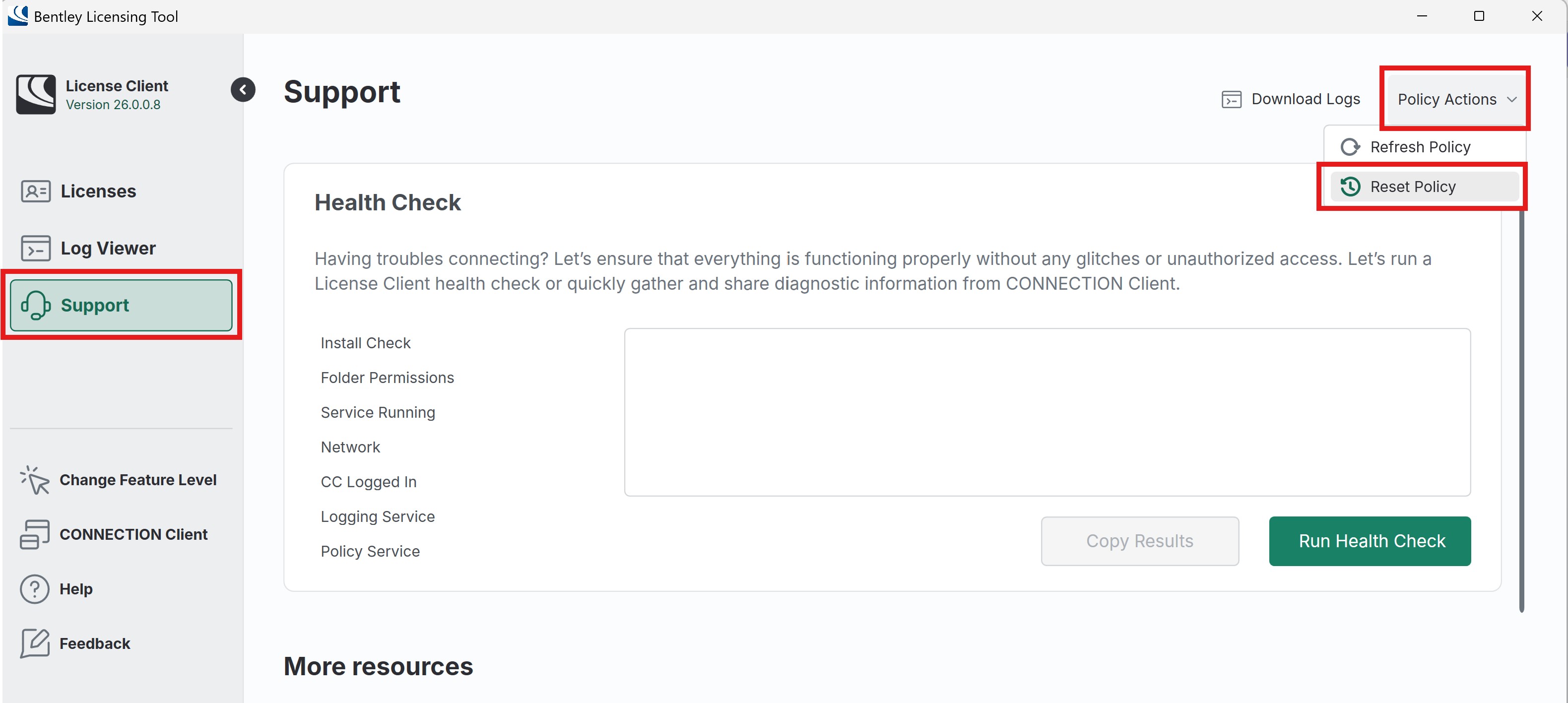

Reset is available in CONNECTION Client 11.00.3.14 or newer. Resetting the policy will empty your entitlements tab and will force a new policy next time an application is used. This option is useful for license troubleshooting or for clearing old licenses.
1) From the Bentley Licensing Tool > Support > Policy Actions > Reset Policy. Click the "Yes I am sure" button to proceed.
See https://bentleysystems.service-now.com/community?id=kb_article_view&sysparm_article=KB0019053
2) If needed, set your feature levels by clicking on "Change Feature Level" at Bentley Licensing Tool.
