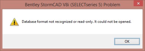

"Database format not recognized or read-only" error
When attempting to open the .STM or .SWR file, you may see the error "Database format not recognized or read-only. It could not be opened.".
First if the file type is not displayed in the file open dialog, type in the full path to the file in the box next to it. For example "C:\Examplefolder\exampleoldfile.swr". Alternatively, you can drag and drop the SWR/STM into the product window.
If this does not help, try opening the 32-bit version of StormCAD, CivilStorm, SewerGEMS, or  SewerCAD. You can find this by going to installation folder and double-clicking on the StormCAD.exe or SewerCAD.exe file. You can also create a shortcut by right clicking on the StormCAD.exe file in the installation folder  and choosing "Send to" > Desktop.
Once this is open, go to File > Open and select the .STM or SWR file (or drag-drop the file, if the STM/SWR file extension does not show in the file open dialog). Once the model file is saved in the current format, you will be able to work on the file in either the 32-bit or the 64-bit version.
If this still does not work or if you're encountering a different error when attempting to open the file, try upgrading to a newer version or contact technical support.
