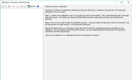

With a completed model ready, you are set to start using Darwin Calibrator. You can open Calibrator by going to Analysis > Darwin > Darwin Calibrator, for Connect Edition versions. In the V8i releases of WateGEMS, you would go to Analysis > Darwin Calibrator.
The Darwin Calibrator window will then open.
To start a new calibrator study, select the New icon in the upper left and select New Calibrator Study. You will then see tabs and available features appear on the right part of the window.

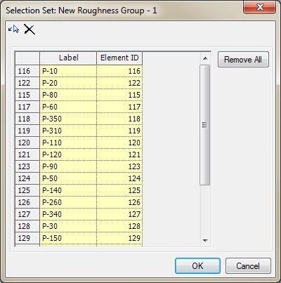

Go to the Roughness Groups tab. Click the New icon to create a new item. It is up to the engineer how many groups to create. The recommended workflow is to group elements that have similar characteristics such as age or material, since it can be assumed that two pipes of the same age or material will see similar changes to the actual roughness (as again, all elements within the groups are adjusted together, not individually). To add elements to the roughness group, click the cell in the Element IDs column and select the ellipsis button.

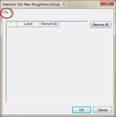

A new window will open. Choose the “Select from Drawing” icon.
The Select toolbar will appear, allowing the modeler to choose elements from the drawing using a few different ways, including manual selection and query, among others. Once you have the elements selected, click the green check mark to complete the selection.
You will now see the elements in the table. Click Okay to return to Darwin Calibrator.

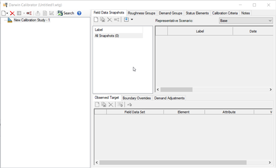

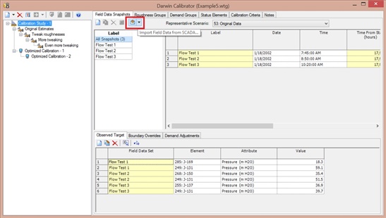

With the adjustment groups selected, now it is time to enter the field data snapshots. Return to the Field Data Snapshots tab. Make sure the representative scenario is set to the one to be used in the calibration study. Darwin Calibrator will pull results from a given scenario to compare to the adjusted values from the calibration study.

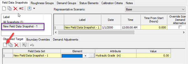

Next, select the New icon below the Field Data Snapshot tab. You will see a new field data snapshot appear.
For the "Date" and "Time" field, enter the respective date and time when the measurement(s) were taken. Be sure that your scenario's calculation options are also set to the right date and time as well - this way it will use the correct demand pattern multipliers and indicate the correct "time from start" (which shows the difference between the scenario's start date/time and the field data snapshot's date/time).
Also, identify a demand multiplier, if necessary. For example, if you have knowledge that your demand is higher or lower by a specific percentage, you can set that value here. The default value is 1.

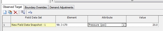

Next, the observed data for the field data snapshot will need to be entered. This is entered in the lower right of the window, below the Observed Data tab. With the field data snapshot highlighted, click the New button under the Observed Target tab. A new line will appear with the Element cell blank.
Click inside the cell, and then click the ellipsis button. Select the element that you have the data for from the drawing or use the Find option. Once you have selected the node, it will be available in the pulldown. With the node selected, the Attribute and Valve columns will be editable. Choose either Hydraulic Grade or Pressure for the attribute and then enter the appropriate value. Enter as many elements as you have field data for.
If you have a field data snapshot for another time during the model run, you can create a new one with a different time. You can then enter observed data for this time as well.
You can also import the field data using Modelbuilder or SCADA, if you have data for multiple elements at multiple times. Steps are importing field data are explained in the help documentation and in this article: Importing Darwin Calibrator Field Data using ModelBuilder

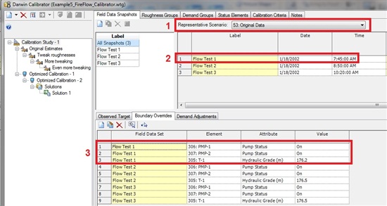

Next to the Observed Data tab is the Boundary Overrides tab. This is also important in a calibration study since it is possible that a tank level or pump/valve status is different from how it is depicted in the model. To get the most accurate results, applicable boundary overrides should be applied.
Click the Boundary Override tab and select the New icon below the tab. A new item will appear, you need to select the feild data snapshot for which you want to apply the boundary override. Select the element as before, keeping in mind that this should be a tank, valve, or pump. Depending on the element chosen, the Attribute field will offer different selections. For a tank, the Attribute can be either Hydraulic Grade or Tank Level. For pumps and valves, setting and status are the options. Again, enter the appropriate value for the attribute selected.

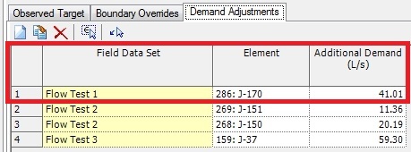

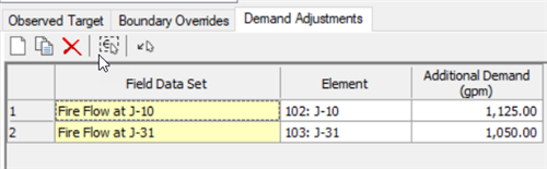

Demand Adjustments is the last tab. This is used to adjust demand for individual elements, such as flow from a hydrant or a junction that occurs only during the time that the field measurements were observed. Enter data here as necessary. Note that the "simulated flow" results at the end of the calibrator run do not list demand adjustments - you can assume that the demand adjustment values that you enter will always be applied during the timestep specified in the field data snapshot during calibration (assuming that you have chosen to use the snapshot in question in a Calibration run).

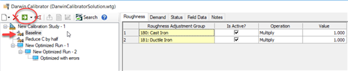

To start a new manual run, click the New icon in the upper left and choose “New Manual Run”. A new item will appear below the calibration study label. On the right side of the window will be a series of tabs. In the roughness tab, you will see the roughness groups created earlier. To make a certain roughness group active, make sure the check box under “Is Active?” is checked. For the Operation column, choose either Multiply or Set, depending on which you wish to use. For Value, enter the appropriate value. Then click the Compute button.
Note: Multiple manual runs can be created so that a number of values can be entered for the roughness.

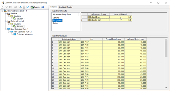

When completed a solution will appear that will include the results from the calibration study. Click “Solutions” directly under the manual run. This will display a fitness value for the solution or solutions. Fitness is a correlation between the observed data from the field data snapshot and the calculated value from the calibration study. The smaller the value, the better the fit.
Returning to the left side of the window, click “Solution 1” to view the results. Under the Solution tab will be the adjusted roughness values for the pipes included in the calibration study. Under the Simulated Results tab will be the elements included in the field data snapshots. (the observed pressure/flow, not the status or demand adjustments) Columns for the observed data and the simulated data with the new roughness coefficients are presented, along with a column showing the difference between the observed and calculated values.

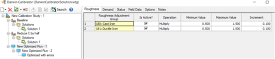

Optimized Calibration Run
The optimized calibration study uses a genetic algorithm to find the best possible solution available within certain parameters. The optimized calibration study has no true optimality and only knows the best solution relative to other solution already found during computation. However, the optimized calibration study runs through a large number of possible solutions and can often find a very good solution to fit the model.
The process is similar to the manual run. Click the New icon in the upper left and choose New Optimized Run. Under the Roughness tab, you will see the roughness groups created earlier. To make a certain roughness group active, make sure the check box under “Is Active?” is checked. For the Operation column, choose either Multiply or Set, depending on which you wish to use. Instead of entering a new value manually for the roughness, you will enter minimum and maximum values, as well as an increment. Then click the Compute button.
Darwin Calibrator will then try different values for roughness that fall within the values entered in the Roughness tab and compare the resulting values to the observed data from the field data snapshots. Darwin Calibrator will continue this until it finds the best solution available. The results are viewed just as the manual run, however there is an option to view as many as ten solutions. See the Tips section below for more information about this.

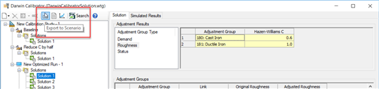

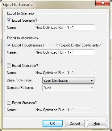

If you are satisfied with the results, you can export the new roughness coefficients, demands, or status to a new physical alternative. To do this, highlight the solution you wish to export. The “Export to Scenario” icon will become active.
Choose this icon and a new window will appear.
To export to a new scenario, check the “Export to Scenario?” box. Do the same for the alternatives. With the check boxes selected the new results will be exported to new physical or demand alternatives (depending on the type of calibration study done). If you export to a scenario and do not export to an alternative (by unchecking the associated box or boxes), the data for that alternative type will be exported to the Base alternative.
Note: The data in your original model will not change unless you use this export feature.

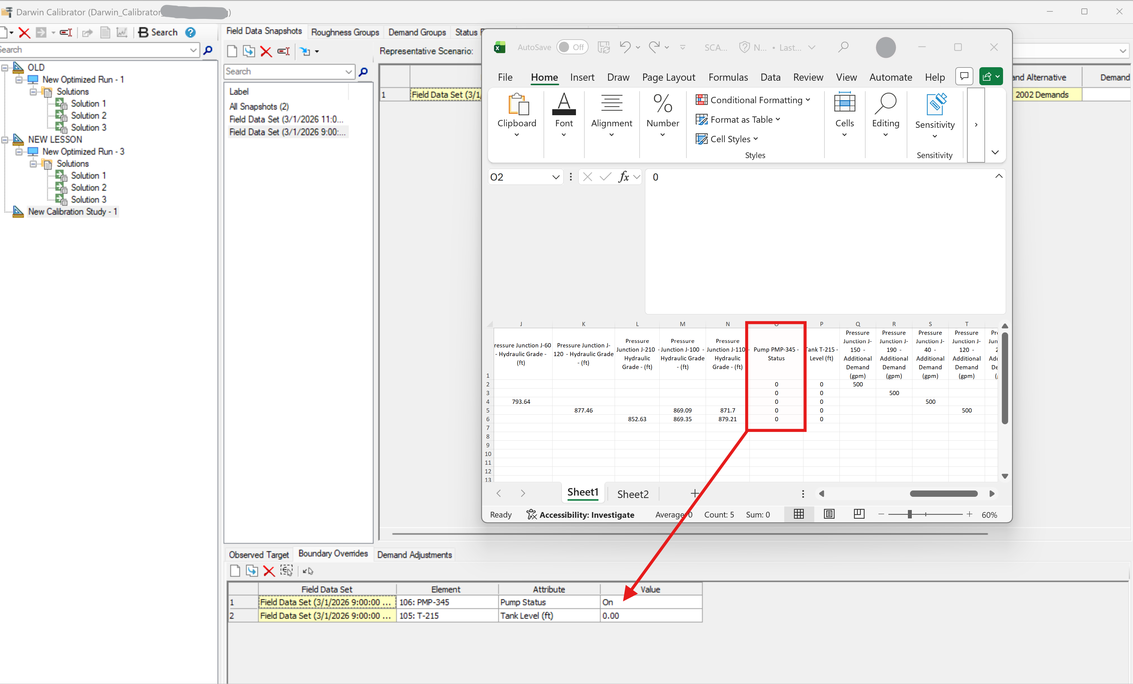

Importing Field Data from SCADA

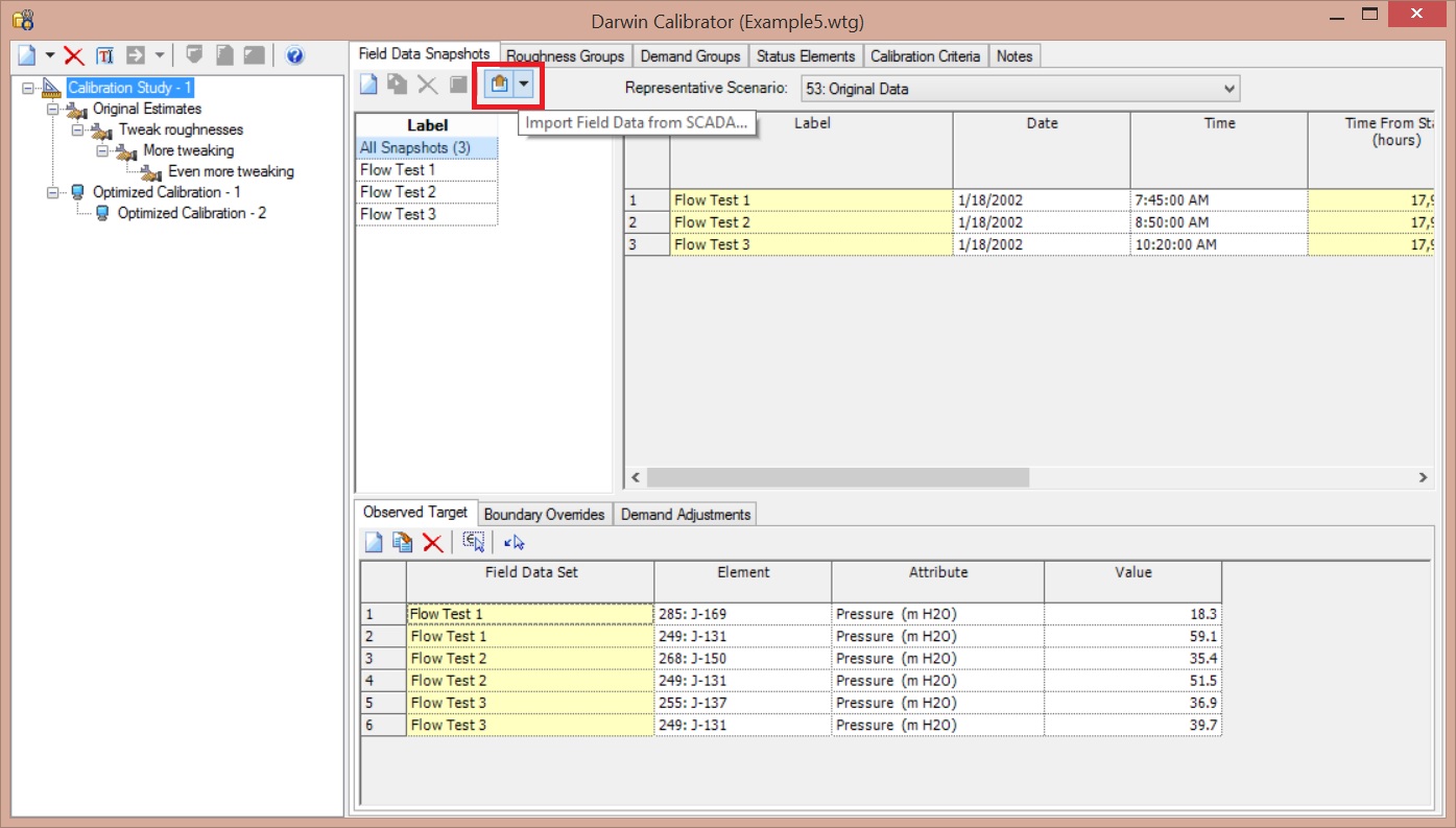

If you have SCADA signals already set up in your model, Darwin Calibrator has an option to import the signal data into field data snapshots. Click the "Import Field Data from SCADA" button in the Field Data Snapshots tab to do this (see screenshot below).
You can then select data to import into Darwin Calibrator. Note that there is no bulk import tool, but you can easily import representative data to use in model calibration.
When importing pump operational status (On/Off) from SCADA datasets, please note that the model does not automatically recognize string-based status values. To ensure a successful data import, you must represent the status numerically in your source SCADA file: map On to 0 and Off to 1. By structuring the raw data this way, the model will accurately convert the numerical values into their corresponding string definitions once they are applied as Boundary Overrides at Darwin Calibrator. See example below.
See more details see the Help documentation topic "Loading Darwin Calibrator from SCADA Data".

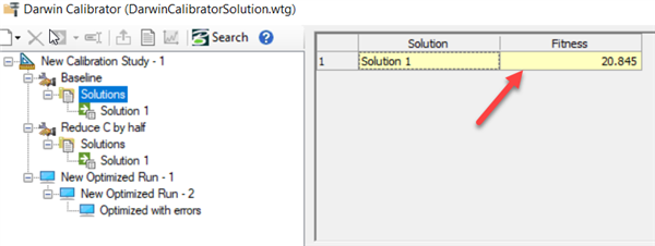

How do I match the results I am getting from Darwin Calibrator in my model?
In order to match the results that you are getting from Simulated Results tab in Calibrator (see image below) you will need to do the following:
1.    Make sure the scenario you are look at in your model is the representative scenario listed in the Field Data Snapshots tab
2.    Make sure the calculation options (Analysis > Calculation Options) for your scenario are set to represent the field data snapshot you are looking at results for.
Calibrator only calculates results for a steady state scenario at a particular time period that you specify in your field data snapshot so it only makes sense to set your model up to reflect this. In this example we are looking at the field data snapshot labeled “Flow Test 1”
NOTE : If you want to run Darwin Calibrator for EPS analysis, then you would need to use a particular time-step from EPS, which will work as steady state calibration.

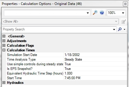

In your model you will need to set your calculation options as follows:
Setting the calculation option for “Is EPS Snapshot? = True ensures that your model is going to use the pattern multiplier that Calibrator used when doing its calculations.
3.    Make sure ALL the boundary overrides, for the particular field data snapshot you are looking at, are reflected that way in your model. For example, if you have pump PMP-1 set to a status of ON in your boundary overrides tab make sure your model has this pump set to a status of ON too.
4.   Make sure that if you have any demand adjustments set that you also add those into your model. Demand adjustments are in addition to current demands already in your model when you run Calibrator, they are not in lieu of them. For example, if you have a demand adjustment of 41.01 L/s on junction J-170 then you would need to make sure to add that to J-170’s demand collection in addition to what is already there for that junction when Calibrator was run.
5.    After you run Calibrator and are happy with the solution make sure you export that solution. In order to achieve the same results in your scenario you will need the adjusted values that Calibrator arrived at for your roughness adjustment groups, demand adjustment groups, and status elements.
After you make all these changes to the scenario in your model just compute and look at the properties of the observed target in your model to make sure it matches the simulated results in Calibrator.
