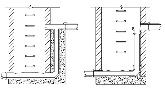

Reducing Plunging Velocity
The velocity of the water dropping into (plunging) a deep drop structure is outside of the scope of the software - this calculation is not done, as it only calculates the velocity of the flow through the pipes and through the structure itself (benching). Further above you can see two diagrams of possible considerations for connecting pipes to a drop structure to help avoid issues with high drop depth / plunging depth, such as odor control.
Using a baffle or bends in the backdrop (vertical pipe directing flow down into the drop structure) could be an option but it would be an engineering decision unrelated to the software. You might find further guidance on this topic in an engineering reference book such as our Stormwater Conveyance Modeling and Design.
Note: any resistance from options like bends, baffles and benching configuration can be modeled using the Structure loss method in the manhole properties.

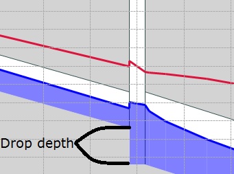

Reporting drop depth of a manhole or catchbasin
