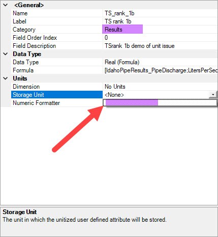

To set up a unitless formula in UDX please refer to the steps and image attached -
- In <General> change the category to 'Results'.
- Select the 'Storage unit' dropdown and click the 'blank' option, now you can see the unit as 'blank' instead of <None>.
- Set the 'Numerical formatter' as a Number.

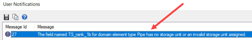

Note - if the fields are not correctly selected, you may see a Use Notification saying - 'The field named TS_rank_1b for domain element type Pipe has no storage unit or an invalid storage unit assigned.' This notification is based on the example UDX formula created referring to the above image.

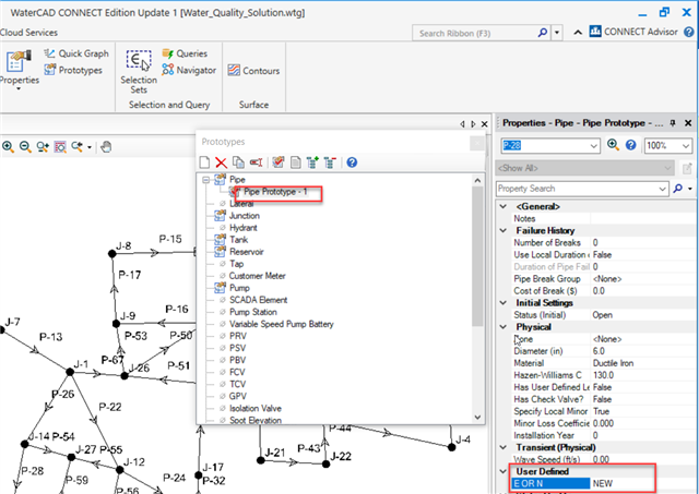

You can create a custom "text" type user data extension for pipes and create prototypes for pipes with the default values of pipe diameter, roughness coefficient and text UDX - NEW PIPE etc.
So, you can specify the old water network by creating a selection set of that and specify user defined field as 'OLD PIPES' for example or simply 'E' for existing network and then create prototypes for new pipes to be laid out. So, whenever you will lay out any new pipes it will automatically be categorized under new water pipe network.

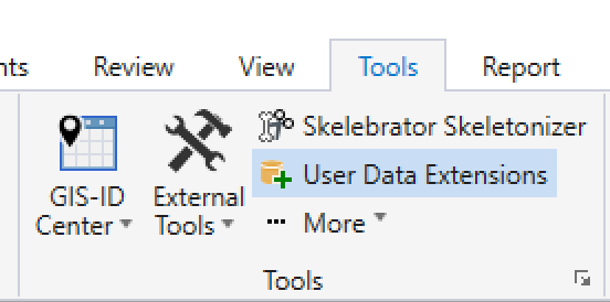

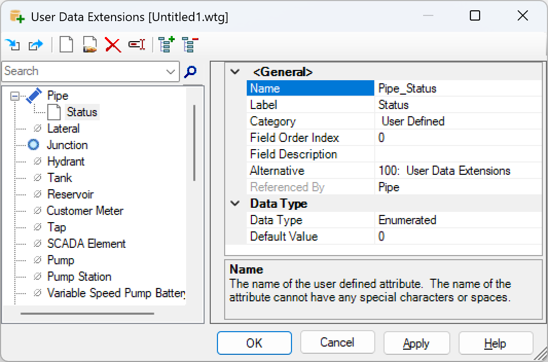

To create a text type user data extension, go to Tools > User Data Extensions > Pipe > right click > Add field > Give name to the UDX > Specify data type as Text, as shown below.
Once custom UDX field is created, you can edit that field through pipe properties or pipe flex table to differentiate between new and existing network.
Then, a prototype can be created which will assign this custom field of NEW for new pipes, whenever you lay out any new pipe in the network which will save your time and confusion to differentiate between new and existing pipes.
Also you can then color code the pipe network to distinguish existing and new network visually for reporting purpose as shown below.
