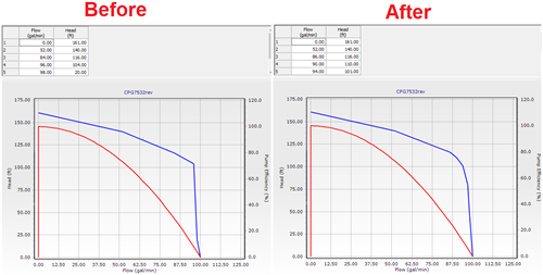

Multi-point Pump Curves
If you are using the multi-point pump curve type for one or more pumps, sharp changes in the curve can make it difficult for the numerical solver to settle on the correct operating point for the pump. This can be especially problematic if the calculation option "Use Linear Interpolation for Multipoint Pumps" is set to "true". Setting this to "false" will smooth out the curve. If this results in a curve that is too far from what you need to model, consider an alternate approach of manually smoothing any sharp points in the pump curve by adding additional points. See example below.

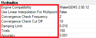

Calculation Options
Several advanced calculation options are available to help with convergence in challenging situations where the model data input and topology has been checked. First, you can try increasing the number of trials. To do this, go to Analysis > Calculation Options. Under the "Steady State/EPS Solver" section, double-click on the active calculation option to view the properties. Find the property field "Trials" and set this to a higher value, such as 400. In many instances, this is enough to allow the program to find a viable solution. Note that the program will not necessarily run all 400 trials, but will only use the number of trials it takes to come up with a viable solution.
Other options to try changing
 1.  Engine Compatibility: Try different solvers. For example, if you are using WaterGEMS 2.2.0, try using version 2.00.12 to see if it helps the software converge.
 2.. Convergence Check Frequency. This option sets the number of solution trials that pass during the hydraulic balancing before the status of pump, check vlaves, flow controls valves, and pipes connected to tanks are once again updated.
 3.  Convergence Check Cut Off. This option is the number of solution trials after which periodic status checks on pumps, check valves, flow control valves, and pipes connected to tanks are discontinued.
4.  Dampening Limit. This is the accuracy valve at which solution dampening and status checks on PRVs and PSVs should begin. Change the value so that it is 10 times the accuracy. So if you have an accuracy of 0.001, set Damping Limit to 0.01.
If that doesn't work, you can also try to increase the Accuracy field (also in Calculation Options properties) to a higher value, such as 0.01. This will mean that the relative flow change between iterations can be higher, which may allow the program to find a solution. You do not want the accuracy value to be too high though, or it may compromise the results.
If you are using linear interpolation, you can try setting this to False, as shown in the screenshot below. This can help in cases where the pump is part of the issue.
 Note that these options are only available for the "WaterGEMS 2.00.12" solver. More information on these can be found at the following support solution: Engine Compatibility modes and Calculation Options.
