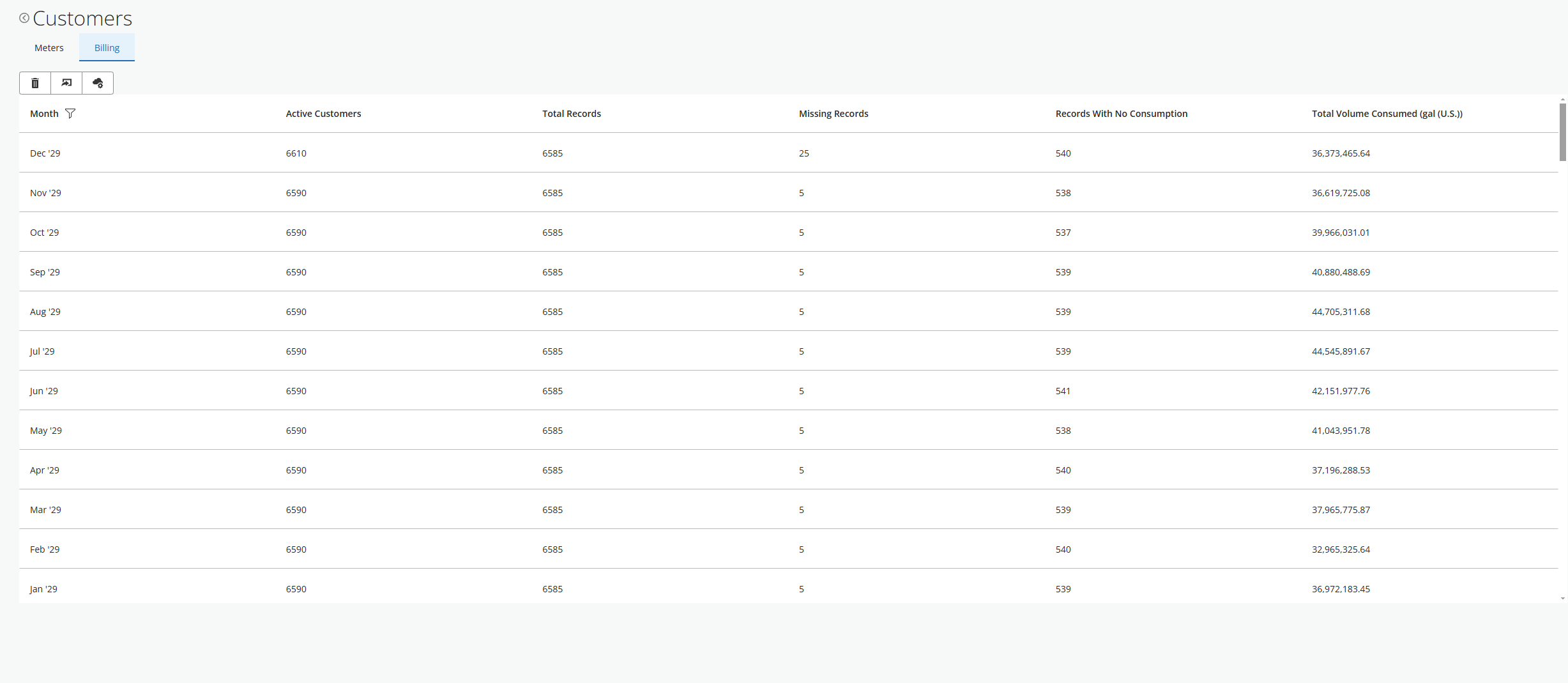

Billing Table
The information provided here is just a summary of all billing records inserted by the user. Through this table the user can easily understand which billing months were uploaded, and the number of customers and billing records uploaded in each month.
Month - billing month
Active Customers - Number of active customers in each month. The number of active customers is based on the customers defined in the "Customer meter excel file", and also takes into consideration both installation date and deactivation date that can be filled. For example:
Total Records - Total number of customers that were uploaded in the billing file which ID matches the one provided in the "Customer meter excel file". It includes customers ID with empty consumption or zero consumption.
Missing Records - The difference between Active Customers and the Total Records. It can be positive if in the billing records are missing some active customers and it can be negative if the billings file include customers that were already marked as inactive in the Customer meter excel file (based on the installation or/and deactivation date).
Records with no Consumption - Customer meters with zero volume consumption defined in the Billing file
Total volume Consumed - Total volume consumed for each month based on the Billing file.
