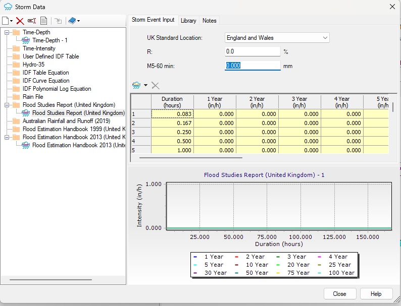

Flood Studies Report
With the Flood Studies Report, you would enter the UK Standard Location, the rainfall depth value (R in the screenshot below), and the expected depth of rainfall in millimeters from a storm lasting 60 minutes with a return period of 5 years. Note: If your units are not in mm, you can right-click on the unit and choose Units and Formatting to change the units.

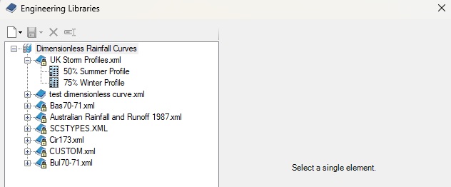

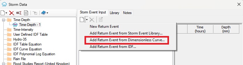

Using Time-Depth or Time-Intensity storm types, you can import the UK Storm Profiles dimensionless rainfall curve. After creating a new Time-Depth or Time-Intensity storm, click the “Add Return Events” button and choose “Add Return Event from Dimensionless Curve”.
This will open the Dimensionless Curve engineering library, where you will be able to choose either the 50% Summer Profile or the 75% Winter Profile.

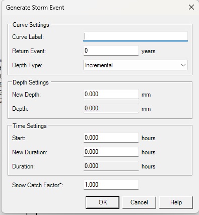

After selecting the curve, you will enter the return event, depth type (Incremental or Cumulative), depth and duration. After clicking OK, a new curve will be available based on the input.

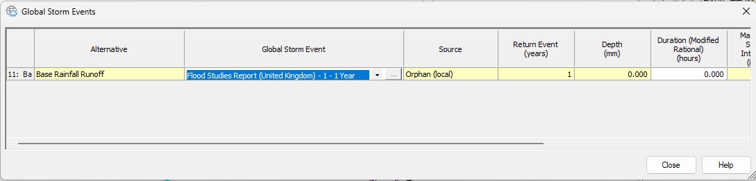

Whatever storm data type is used, once the storm data is inputted, the storm is assigned to an Rainfall Runoff alternative using Global Storm Events (Home > Storm Data > Global Storm Events or Components > Storm Data > Global Storm Events).

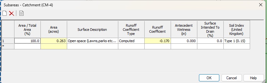

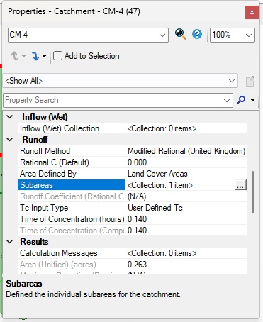

With the Modified Rational (UK) Method, you will define the time of concentration the type of area (Single Area, Multiple Subareas, and Land Use Area). With Multiple Subareas and Land Use Area, you will have a collection field with input for the area.

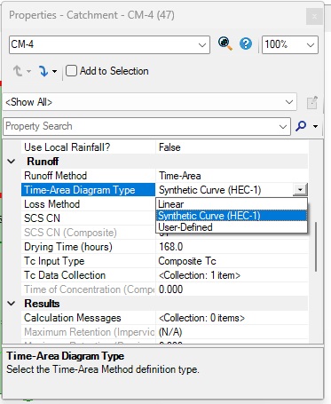

With Time-Area runoff method, you will define the Time-Area Diagram Type (User-Defined, Linear, and Synthetic Curve (HEC-1). The input parameters in the properties will change based on the input.

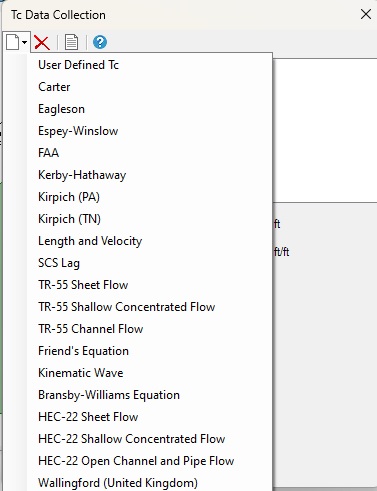

Time of Concentration can be added as a user-defined value, but if you select Composite Tc for the “Tc Input Type” field in the catchment properties you can select from a number of calculation methods for time of concentration, including Wallingford (UK).

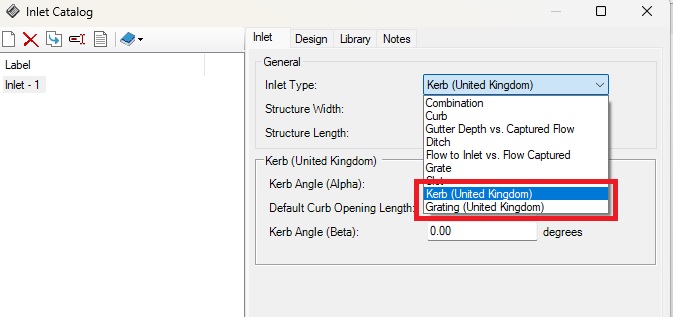

There are two UK-specific inlet types in the Inlet Catalog: Kerb and Grating.

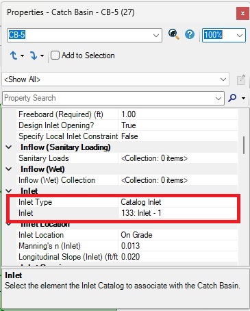

The Inlet Catalog is available through the Ribbon search or Components > Catalogs > Inlet Catalog. When you choose the inlet type the input parameters will be available. Once you have the data entered, you will be able to choose the catalog inlet in the catch basin properties.

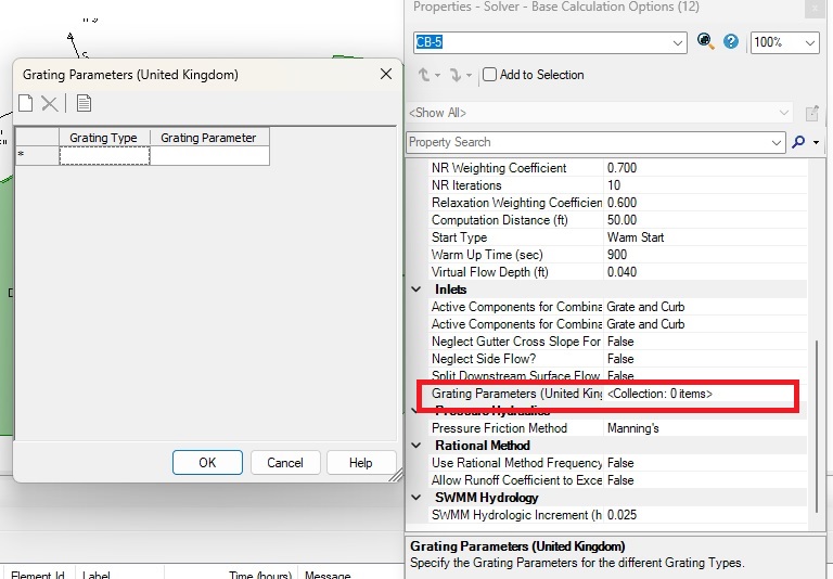

If you use the Grating inlet type, there are additional parameters that need to be entered in the calculation options. In the Inlets section of the calculation options, click in the Grating Parameters cell to enter the Grating Type and Grating Parameter.
