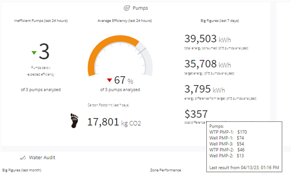

  2. Define a target efficiency for the pumps, inside Administration >> Settings >> Service expectations.
  3. Define an average energy price, Administration >> Settings >> Costs.
  4. Go to the Home Dashboard, to the Pumps section. Take a look at the overall costs (cost difference from target).
  5. Hover the mouse over the costs number to have a drill into the top 5 pumps in terms of inefficiency costs. Please note that these inefficiency costs are referred to last week.

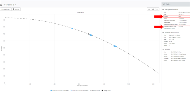

         6. Go to Pumps dashboard and drill in to the pumps details of those with higher inefficient costs (those identified in point 5).

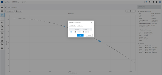

         7. In the Pumps detail, change the period (under Manage Series) to cover 1 year period.
8. Take a look at the annual inefficiency costs (cost difference from target) for each of the pumps identified in point 5 as well as the overall annual efficiency
9. These annual inefficiency costs (cost difference from target) correspond to the costs the utility is incurring by having pumps working at efficiencies much lower than the expected ones (the expected target efficiency is defined by the user under Admin >> Settings), for similar operating conditions of flow and head. These costs can help the utility prioritizing the pumps that should be further investigated or intervened, which can include for example inspection, maintenance, or even replacement.
