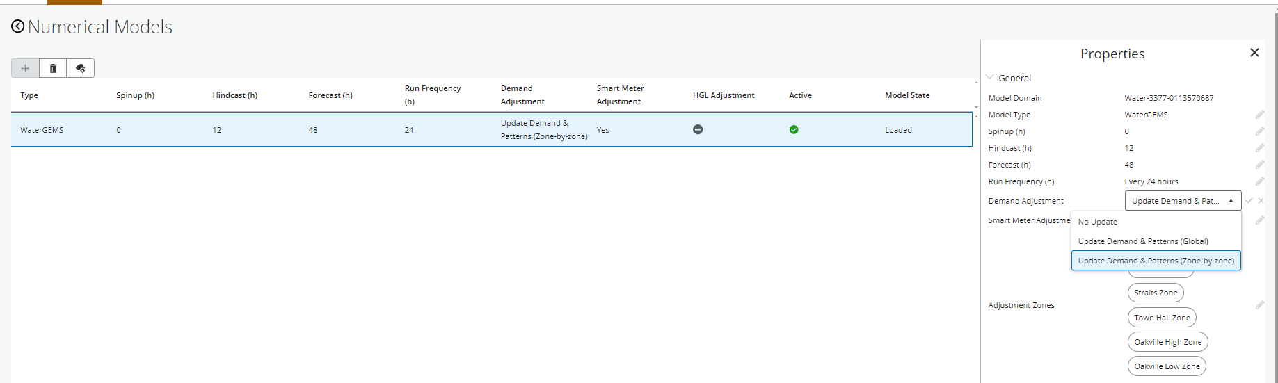

WaterSight can automatically calibrate your model demands. There are two options available: update demands by using a global pattern or updating demands by using a different pattern for each zone. When selecting zone by zone, the user can also choose which zones to be considered.
WaterSight will automatically compute a pattern for the global system or for each zone based on the real system total flow or each zone flow and will automatically apply it to the nodes belonging to the respective zone. For better accuracy it is recommended to use the option to update demands zone by zone.
This configuration is done in the Numerical Model Administration page (Administration >> Numerical Models).

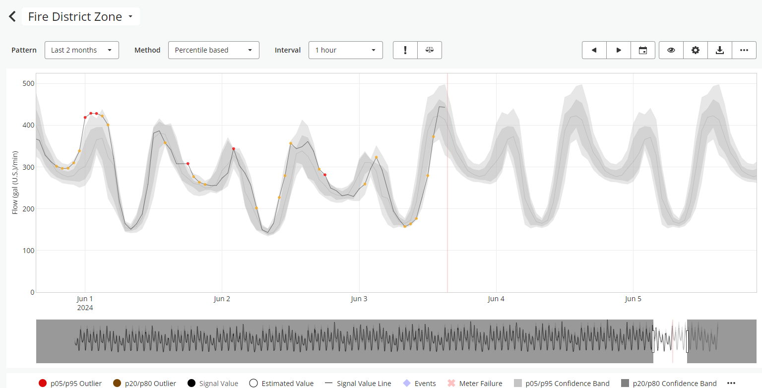

The user can analyse each zone dimensional pattern automatically calculated by WaterSight by acceding to the Zone details graph (under Network Monitoring page). The pattern used in the model is the represented with the grey line (P50). This is the dimensional pattern that will be automatically transformed into a dimensionless pattern (zone demand multiplier) used to multiply all existent node demands of the hydraulic model, in case this option is enabled in the Numerical Model settings. The user also has the option to export the zone dimensional patterns to CSV by clicking in the Download button  located on the top right of the graph

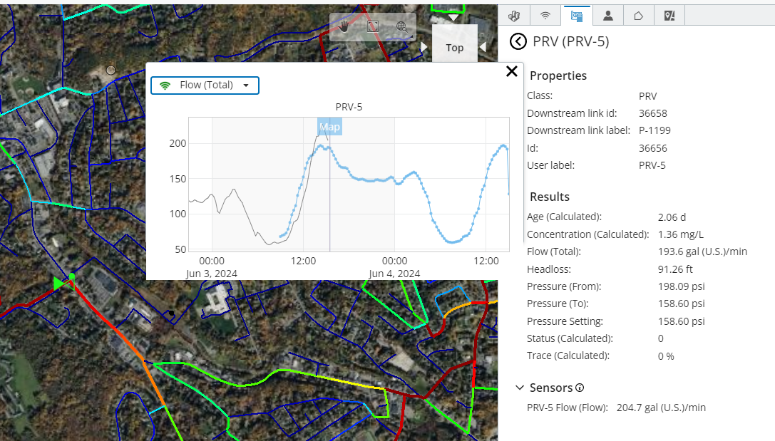

To check and confirm that the model accuracy improved, the user should can go to the real time simulation page and click in any sensor icon that is measuring flow (represented by a wi-fi symbol). Sensors icons highlight that a specific hydraulic element has a valid sensor signal associated to it, and therefore model and measured results can be compared. Below an example where a PRV modelled flow (at blue) is compared with the measured flow from SCADA, at black (with the zone demand adjustment option enabled).
If you want to compare this new result with the status quo condition (with no demand adjustments calculated by WaterSight, this means using the exact same configurations defined in the WaterGEMS model) please go to the Numerical Model settings (inside the administration) and set the demand adjustment option to "No update". Then wait for the next model run, and accede to the same model element by clicking in the wi-fi symbol. Compare again model and simulated results.

In case there are significant differences between model flow (blue line in graph above) and real flow (black line in graph above) first make sure that the option to enable automatic zone demand adjustment (zone by zone) is enabled in the  Numerical Model settings (inside the administration).

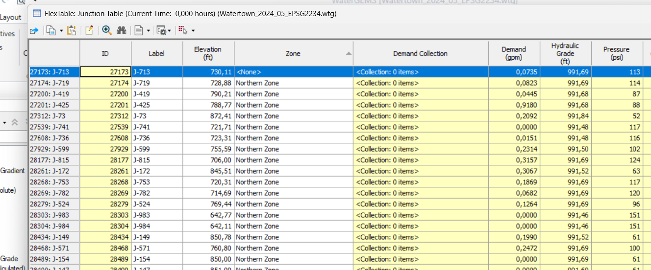

If this option is enabled next step is to check if all the junctions in the WaterGEMS model that belong to that zone have the zone field assigned or if the zone name matches exactly the one defined in WaterSight. Note that for the model nodes with no zones assigned or with zones names different that those defined in WaterSight, patterns and demand adjustments will be ignored and the model base demand and units demands will be taken into account. This means for example that if a junction that belongs to a specific zone does not have a zone assigned in WaterGEMS and has a consumption of 10 l/s, and assuming the real average zone flow is 20 l/s, those 10 l/s will be added, which will contribute to a final zone average zone flow in the model of 30 l/s (instead of 20), which is not correct.
Figure 1- Assigning zones to the junctions in the WaterGEMS model. Example of junction J-713 with no zone assigned.

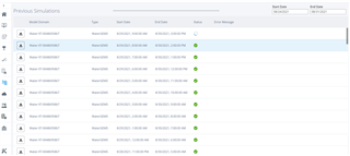

Besides this, it is also possible to export and further analyze the dimensionless pattern generated by WaterSight. Please go to Realtime Simulation page > Previous Simulations and download the latest simulation.

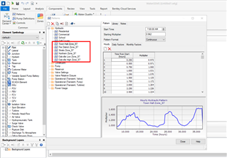

Then open the sqlite file in WaterGEMS, go to Components > Patterns. Patterns automatically generated by WaterSight are automatically exported and can be analyzed in WaterGEMS. Pattern names are automatically generated based on the zone names in WaterSight.
Note: The pattern automatically generated in WaterSight and exported to WaterGEMS comprises the all simulation period defined in WaterSight (which can be more or less than 24 hours). Because week day and weekend patterns generated by WaterSight can be significantly different, in case the simulation period comprises a Friday and Saturday for example, two different patterns (for weekday and weekend) are combined into a single one automatically. Also note that in WaterGEMS it is required the starting multiplier of the pattern to be exactly the same value as the last multiplier, therefore this additional and last value is added only when exporting to the WaterGEMS file, but it is not being considered in the WaterSight simulations.
