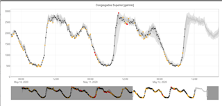

The user has the ability to control if an event should be considered for the pattern and forecasts calculations of the sensor/zone or if should be ignored. The pattern is represented in the graph of each sensor/zone by a grey band and corresponds to the expected behaviour of the sensor/zone. For more information about patterns, go for example to the Sensor Overview help page.
Figure 1- The pattern confidence bands are represented with a grey color while real values (sampled in 15 minutes time step or hourly or daily) are represented with a black line and colored dots.

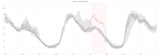

Generally all alerts that represent anomalous or extraordinary events (such as bursts, leaks, fires, tank overflows, temporary zone changes and meter failures) should not be considered for the pattern calculations and forecasts of the respective sensor, as those events will not repeat in a periodically basis or represent wrong function of the meter.
Figure 2 - Burst alert example. Real values (at red) outside the pattern confidence bands.

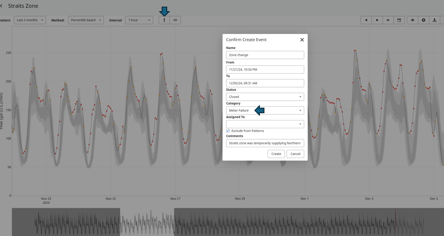

The user can  manually "Add" events in order to to assure that specific periods are not considered for the patterns calculations. Steps are below:
  1. Access the sensor or zone graph detail and zoom to the period that should be ignored
  2. Add a manual event for that period by clicking in the   button above the graph, and define the event category as meter failure. You should also close the event (so it will not get displayed in the active event list and in the map) and make some comments. See image below. After the meter failure event is created it will be highlighted in the sensor graph with a red cross symbol. The user can create multiple meter failure events if there are different time periods he wants to ignore.
By doing this, patterns do not become "polluted" by anomalous events or data failures, even if no alerts are triggered/configured and are being automatically generated by the solution.

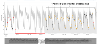

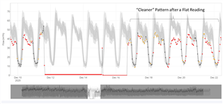

Flat Reading event. Exclude from Pattern option NOT checked.  Flat Reading event. Exclude from Pattern option checked.

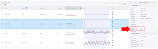

The user has always the option to override these defaults by manually changing these settings in the Event Properties table, in the Active Events page, by checking or unchecking the Exclude From patterns option, as shown in figure below.
Figure 3 - Manually change "Exclude from Patterns" option.
