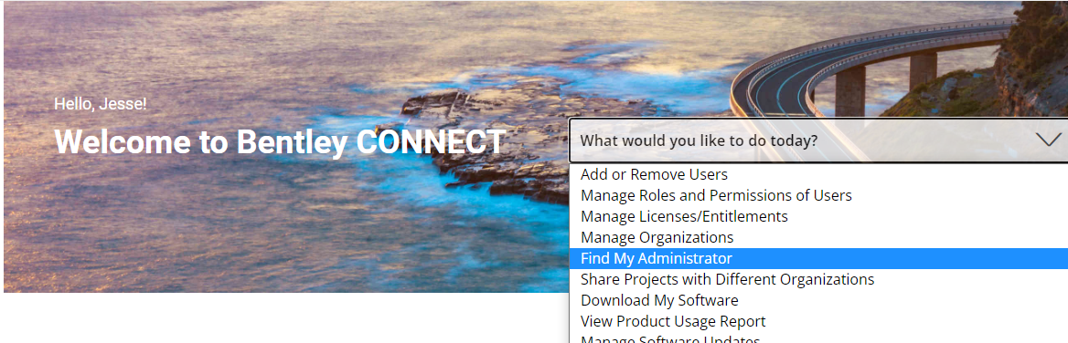

NOTE: If another person in your organization manages your Bentley OpenFlows licenses (such as your IT or HelpDesk administrator), please share the following information to guide them through the upgrade. A list of your Administrators can be seen by going to https://connect.bentley.com. On the right side of the Welcome Banner, click the dropdown and select "Find my Administrator". In the next screen, scroll to the bottom and expand "Account Administrators".

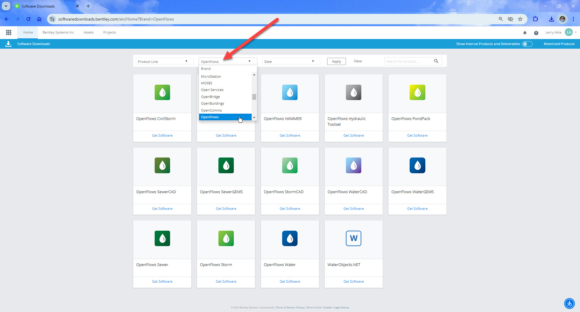

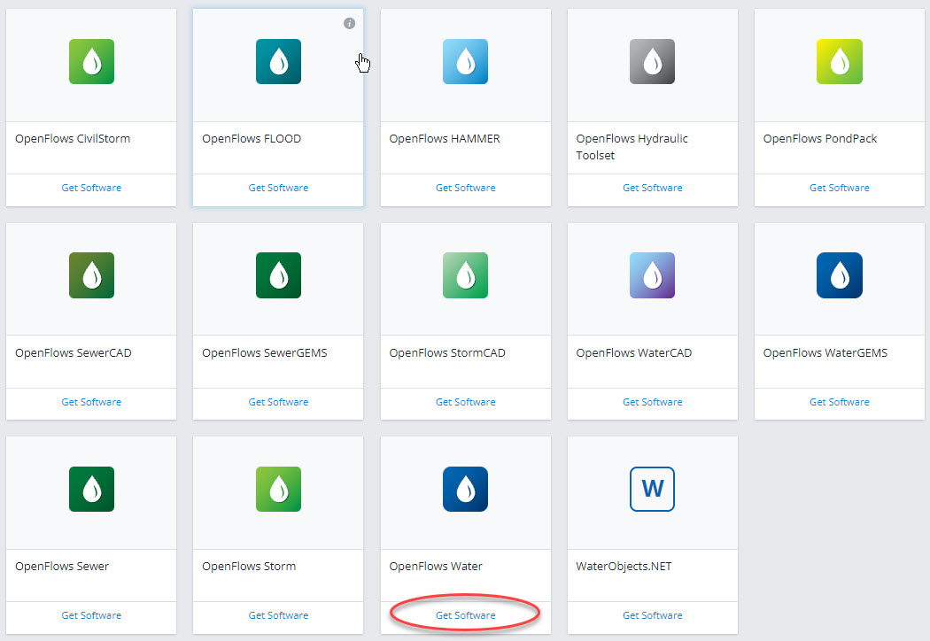

Select OpenFlows from the Brand pull-down menu and click the Apply button to see the latest OpenFlows products.
3) Download the desired product(s)
When you see the product you want to download, simply click the "Get Software" link on the tile:

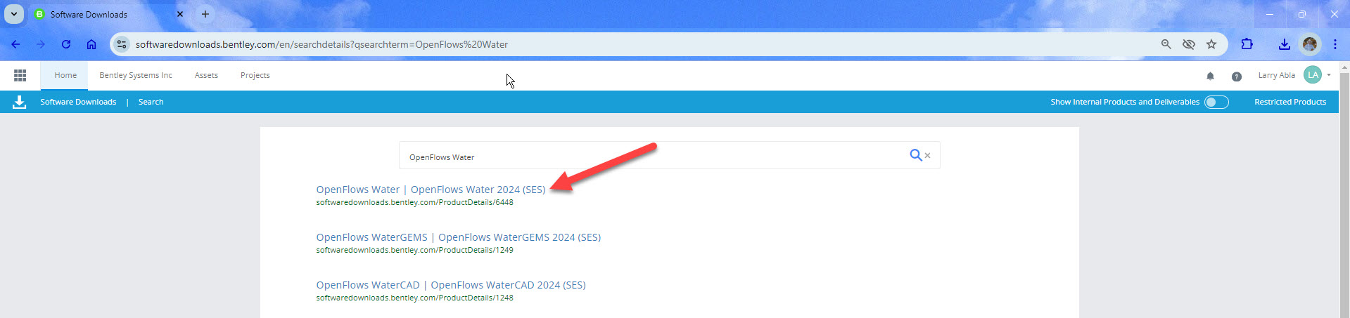

Next, click the first link in the search results for the latest version of the product you want to download:

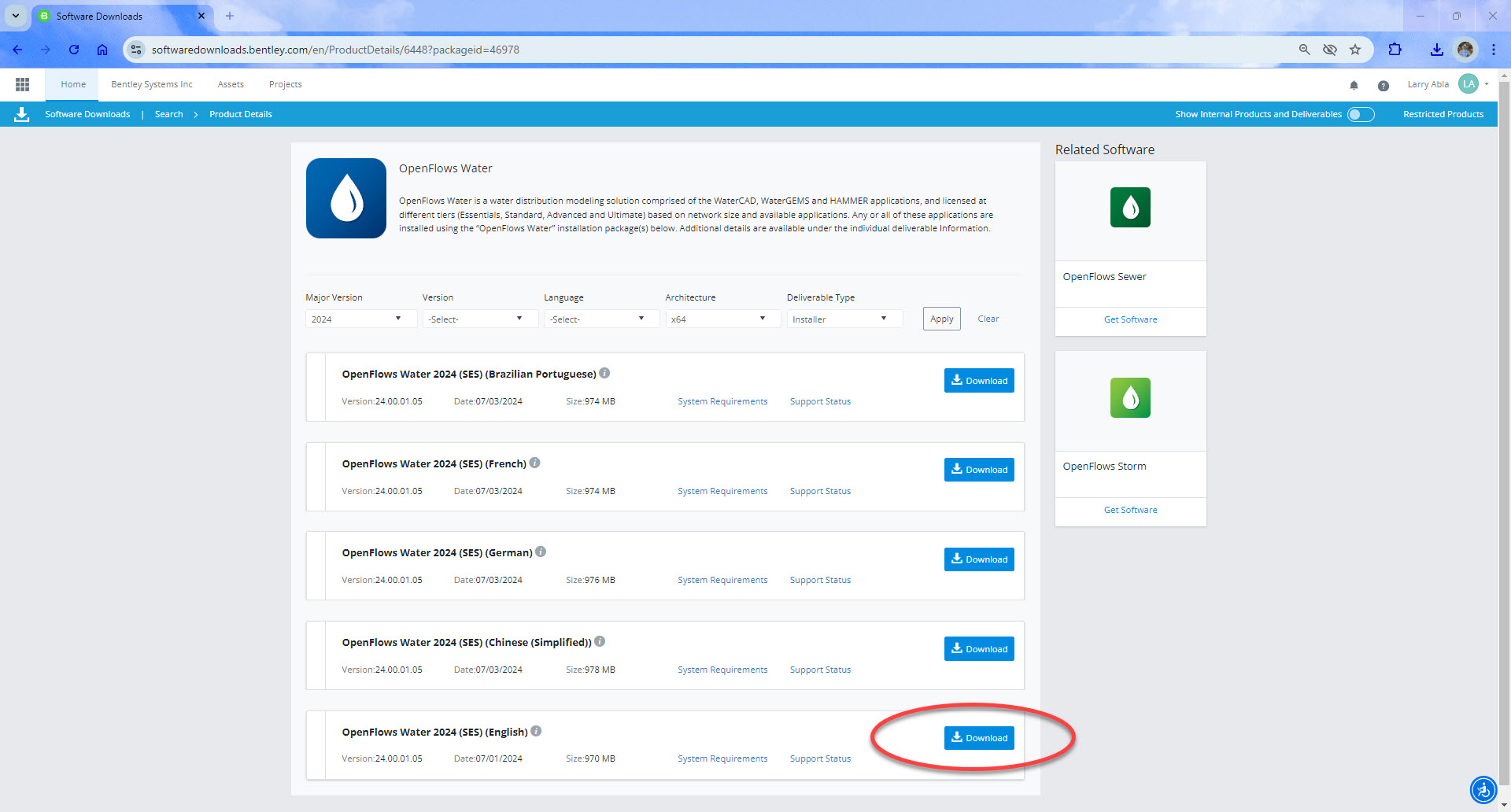

In the list of versions for your selected product, click the blue "Download" button to the right of the version you want to download.
Note:
Note: By default, the latest release of the language last uploaded will be displayed. If you are looking for the latest version of a given language, such as English, simply adjust the filters as needed, such as changing the Language filter. When you click Apply, the latest version for that language will appear.
