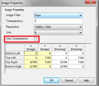

5) Other raster file formats such as (*.bmp, *.jpg, etc.)
Other raster file formats such as (*.bmp, *.jpg, etc.) can have similar problems.  Some formats are compressed on disk, some are not.  Looking at disk size is not always a good indicator of how much memory is required to load and draw the file in the standalone program.  Additionally, the program needs to load it into a contiguous (unfragmented) block of memory. If many programs had been opened during their windows session, those things may be loaded into random sections of memory, which makes it much more difficult for the program to find a contiguous block of that memory to load the background. If you get an out of memory error with one of these file types and rebooting the computer does not help free up a contiguous block of memory, try opening the file in an image editing program (Photoshop, Paint, GiMP, ...) and lower the resolution/dimensions. For *.JPG files there is a use compression checkbox that you need can select, which should help the image load more efficiently.
